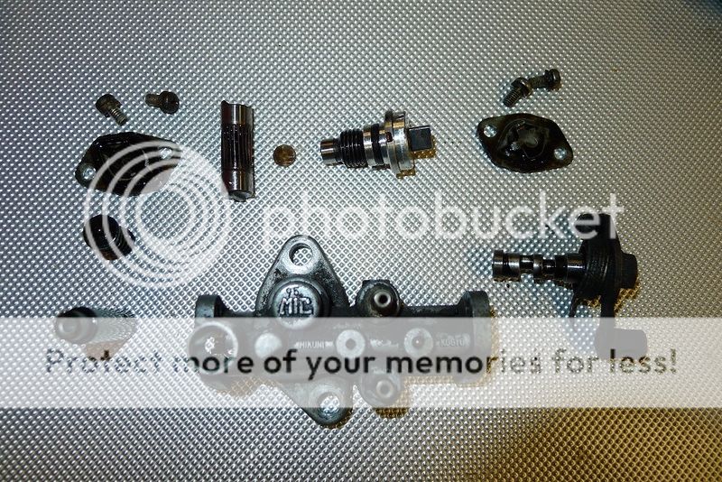

Ive never liked the omp set-up and recently my omp started to leak so I decided to have a look at modifying it. I have a spare pump so decided to pull it to bits to see how it worked.

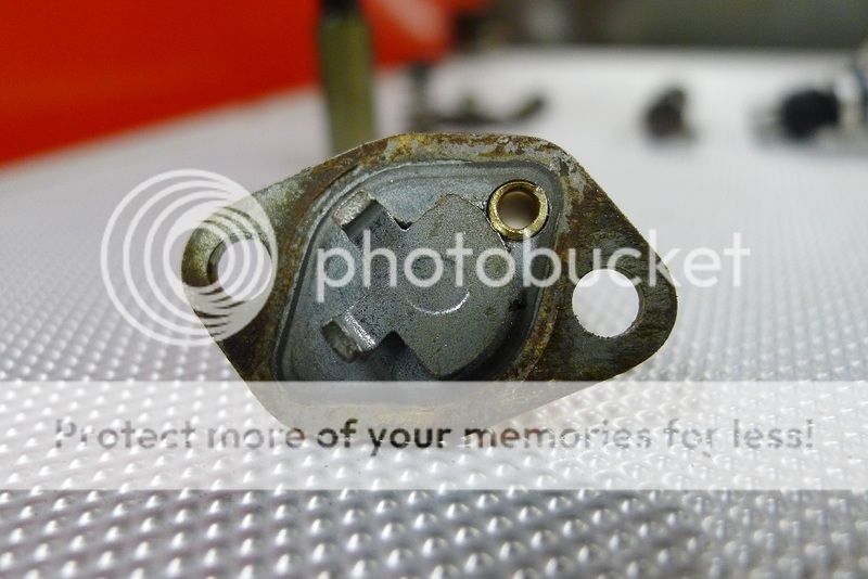

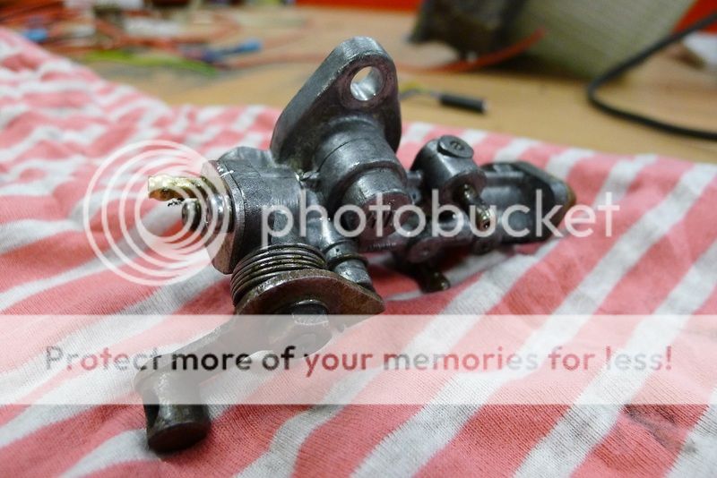

With the pump in bits I could see how it worked and I could also see where it took the engine oil into the pump, after a bit of studying I worked out that by drilling and tapping the end plate and blanking the original oil feed hole I could feed oil to the pump from a seperate reservior.
Now all back together and ready for test.

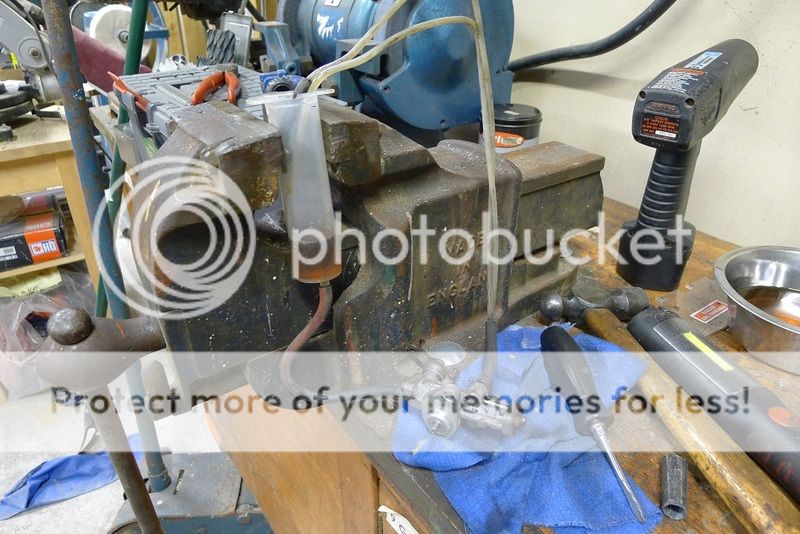

I cobbled together a test rig with a battery drill to spin the pump and to my suprise it seemed to work fine :D

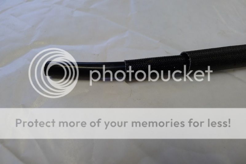

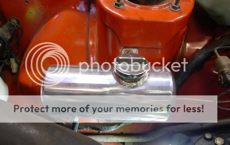

Now I knew it was working I splashed out on an e-bay special polished aluminium header tank, some silicone tubing and some heat proof sleeving to go over the tubing as it is quite close to the exhaust. It was all fitted in about 15 mins and the tank filled with 2 stroke oil. Now feeling quite smug :roll:
That's 2 strokes of purest genius Keith.
Solves the problem with the OMP of 'Is it?', 'Isn't it?'
Presume you can just check the level in the header and see that the OMP is doing it's stuff.

That is a superb mod, Keith. I've been meaning to get one of those Rotary Aviation spacer block things for ages, but this looks just as neat but even better, DIY. How did you block off the oil feed from the block though? Am I being dense and missing the obvious?
I put a blob of chemical metal in the hole in the pump and made a new gasket that covers the hole. I'd like to get a vertical level sender to put in the filler cap if I can to save drilling holes in the reservior.
I'd also run a clear/translucent oil resovoir that's easy to see and check. Your update is working under all conditions?
At the moment I'm running the pump at maximum all the time, it doesn't seem to smoke alot but it is most certainly using 2 stroke oil, still keeping a close eye on everything while testing.
