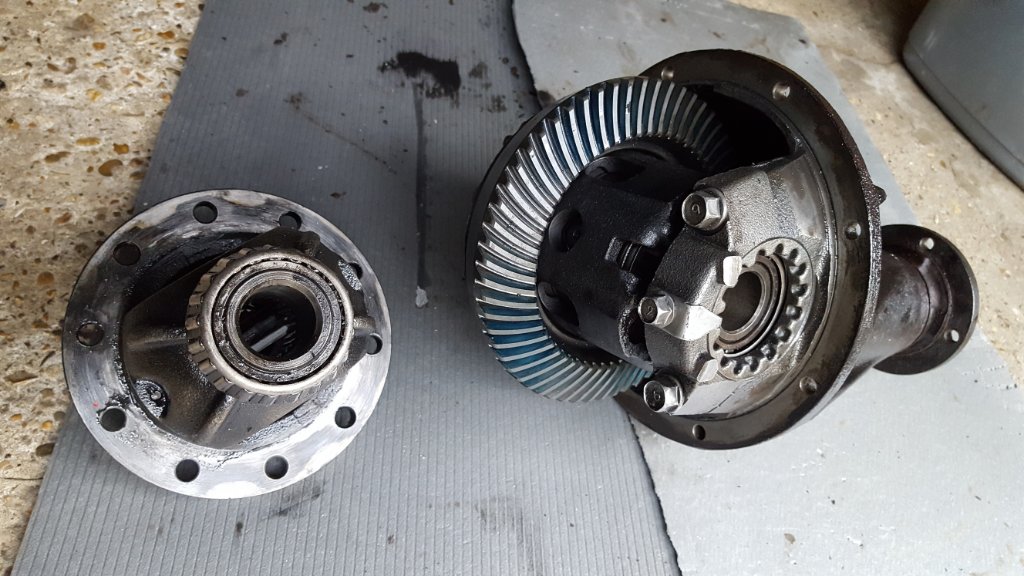

The open diff was swapped out with a rebuilt LSD clutch type unit. I fitted this about a year ago Tool sourced, revuilt and installed the LSD into my carrier.

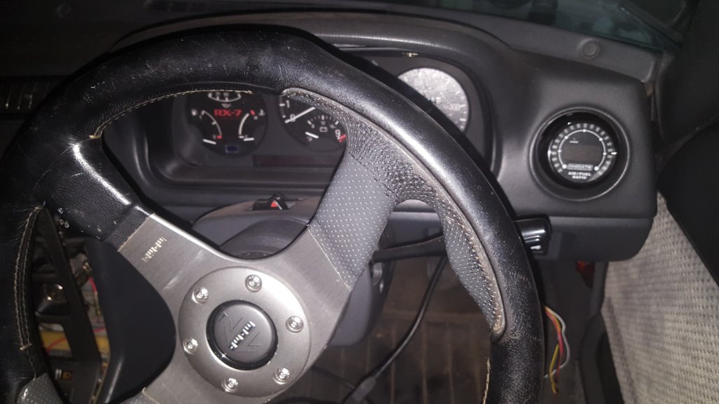

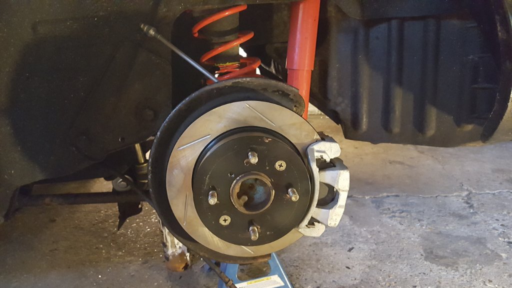

Between house renovations and the arrival if my son progress has been at a snail's pace over the last couple of years but I managed to install an MSD ignition box, changed the leading ignition to direct fire (bypassing the cap and rotor). Also, I replaced the rear brake discs with slotted Stoptech ones sourced from Rockauto.

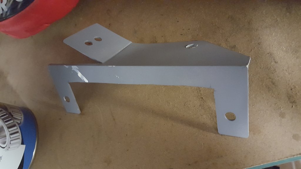

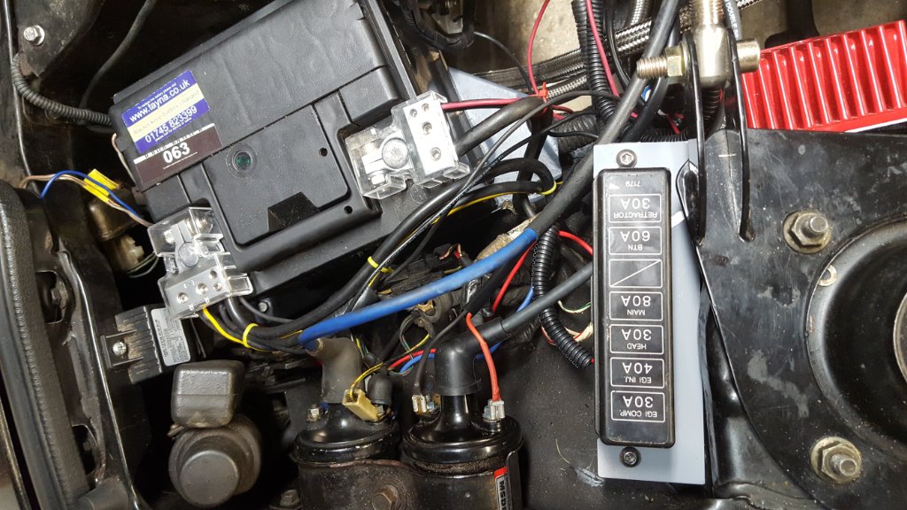

And lastly I fitted an FC fuse box after i made a bracket from aluminium angle to attach it in a convenient place in the engine bay.

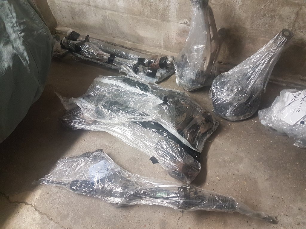

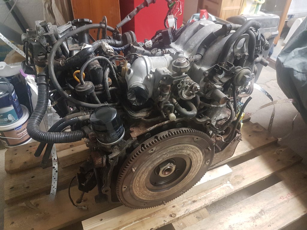

Also, I had this exciting arrival!
13B turbo engine, FC subframe, control arms, hubs, steering rack and column and an FC propshaft.
This is the direction I eventually want to go with the car after ive had a chance to enjoy a couple of years with the current setup. This will be a big project for me and is a long term goal so I've been reading a lot of "FC subframe swap" build threads first.
