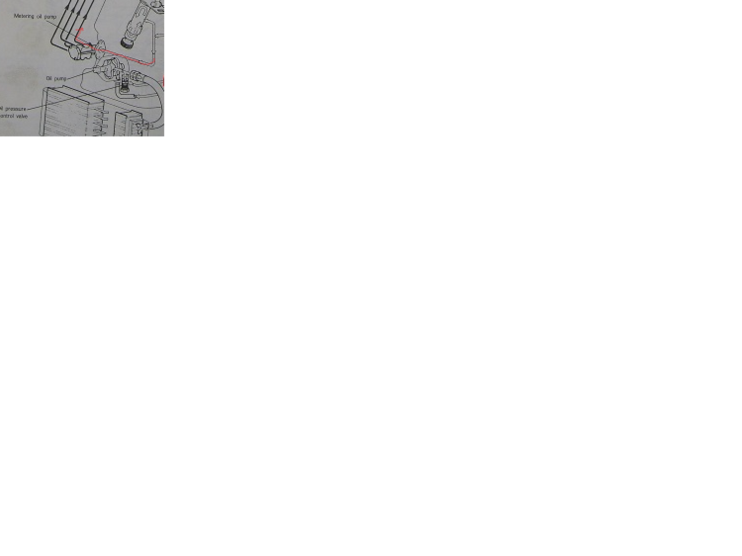

So is there oil feed pressure at the standard 12A OMP?
the OMP is driven by a gear off the eccentric shaft.... the actuator rod going to the carb opens the valve in the pump which lets oil through according to engine revs
codge wrote:So is there oil feed pressure at the standard 12A OMP?
Yes! Feed is from the engine oil circuit.

OK, thanks for that guys.
When I did the 2k rpm for 6mins test it delivered well over 2 - 2.5cc and as I have my omp oil lines going directly to the IDA manifold I suspect the vacuum pulls even more. I have had a good drive today and it is using a decent amount of 2 stroke oil so I think I'm ok.
Thanks for the info Thomas, I thought the oil feed to the omp was on a return 0-0
