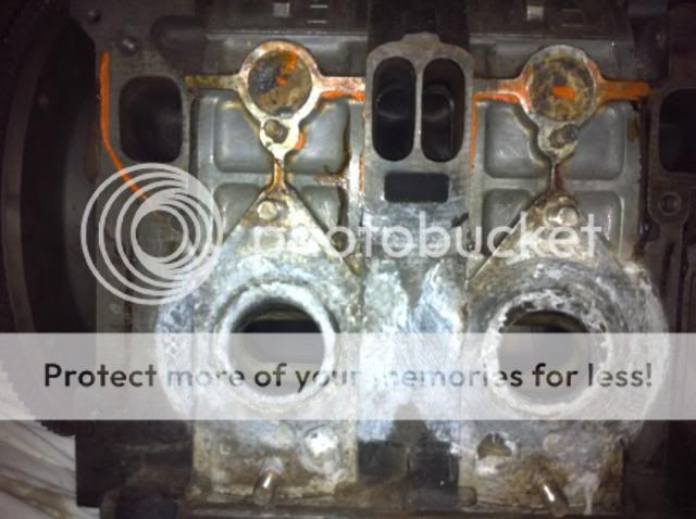

You can get away with a reasonable size BP on the street. It comes down to personal preference. The bigger the BP, the harder it will be in traffic. I have a pretty big BP in one of my RX2s. It idles at 1500rpm all day. This isn't an issue imho.
Here is a pretty big 13B BP:
It really doesn't like low revs. But how much of this is down to the fact that I am running an IDA?
With an IDA, you lose the primaries and secondaries. But with a Niki carb, you keep the primaries and secondaries and therefore you can extend port the primaries and BP the secondaries, giving you the best of both worlds.
