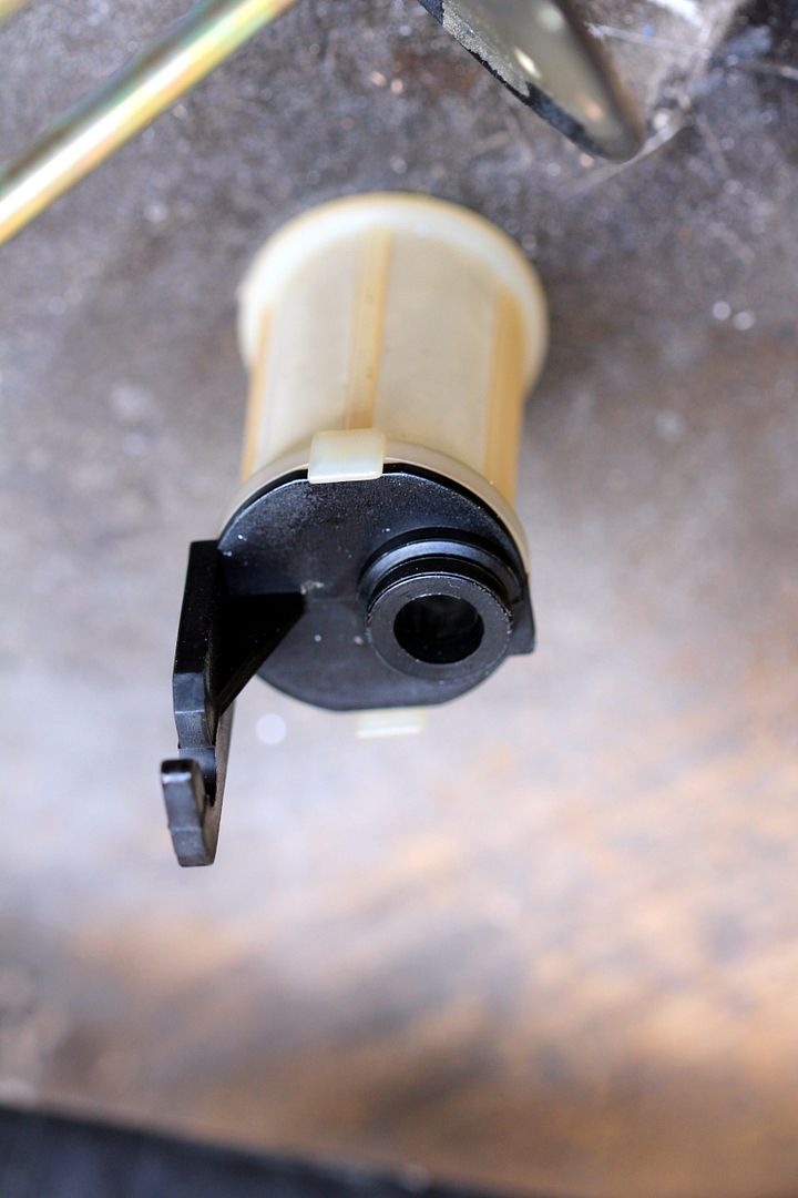

Oh, and finally, finally.... found this little filter thing rolling around loose in the bottom of the tank. I'm guessing it should be attached to something, lol. What and how?

Lucky wrote:Oh, and finally, finally.... found this little filter thing rolling around loose in the bottom of the tank. I'm guessing it should be attached to something, lol. What and how?
Think you must ask Damon :D

The filter thing goes on the end of the pick up pipe... when you remove the hardlines from the tank, you'll see which one it goes on, if not, check out the thread on that silver car I scrapped.

The filter thingy goes on the end of the supply pipe.

This is what I figured, but I'm confused by the little black plastic clip thing... there doesn't seem to be anything for it to clip to :? It clearly only fits on the one line in the tank because the other is too small a diameter, but it's hardly what I'd say a tight fit. Is it really as simple as when it's in place there isn't enough clearance between the bottom of the filter and the base of the tank that there isn't space for it to fall off? Seems weird :shock:
I found this on Ian's silver car build thread
but I dunno if that helps. Is that really how it fits?
