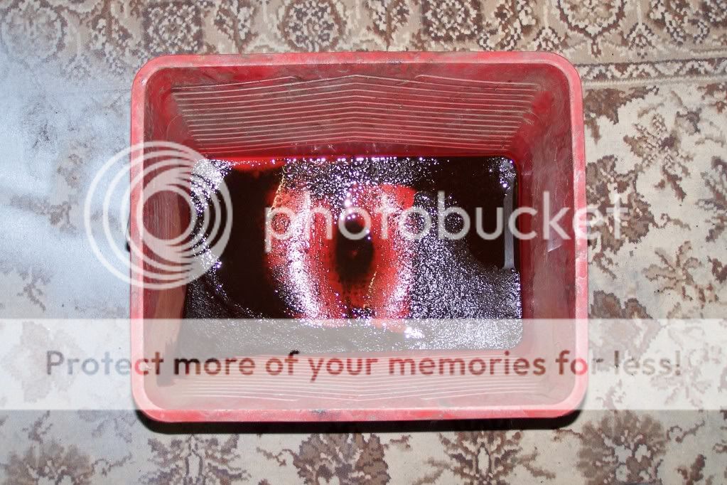

This is what came out of one of my tanks:
My advice;
Flush the tank as best you can. You really need to remove it as draining it only does so much.
Replace the pump. A facet one will be fine.
Replace the filter. Cheap, so get a couple or three. I suspect you'll go through them very quickly, as in 30 miles.
Add an extra filter immediately before the carb or you'll fill the carb with crud from the lines, than you'll be rebuilding that too.

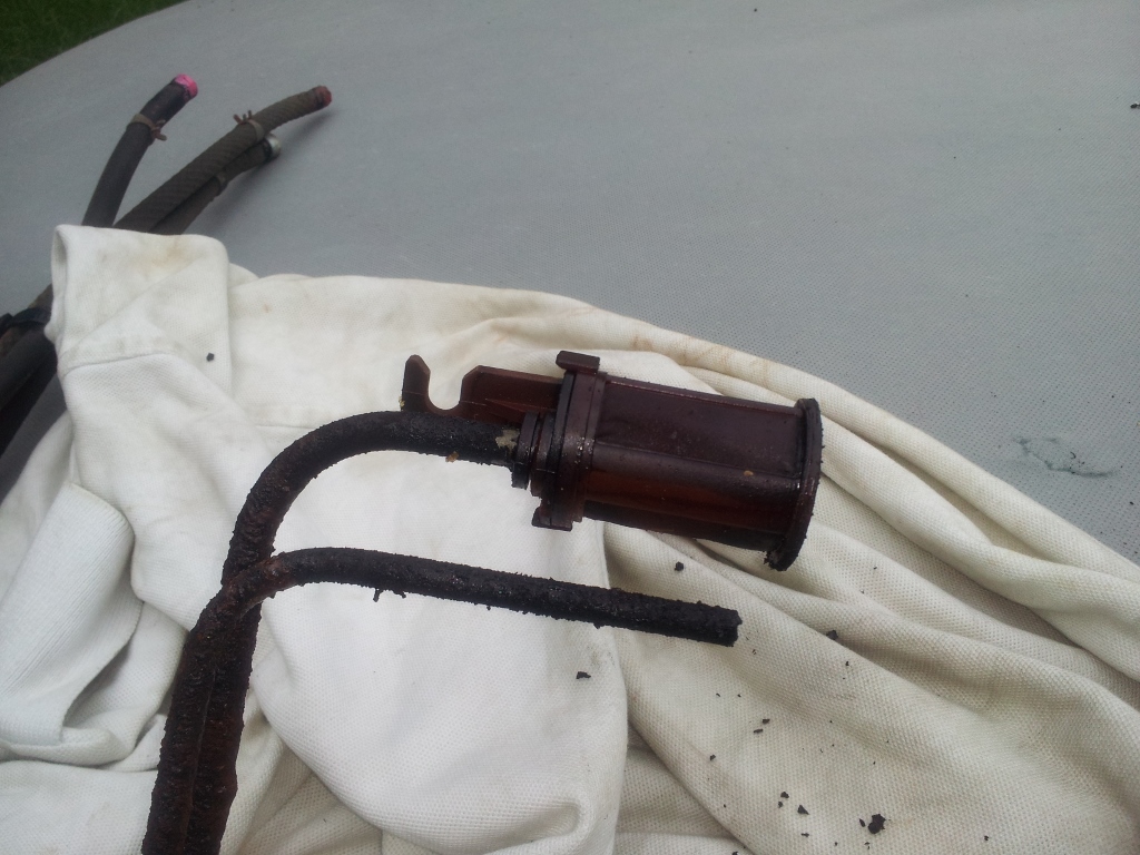

Thanks for the advice. . . I've already dropped the tank and will clean it out using a POR15 kit. . . I hear this works pretty good. The current problem I'm facing is finding a replacement fuel strainer. Been having a heck of a time finding one! Any ideas?

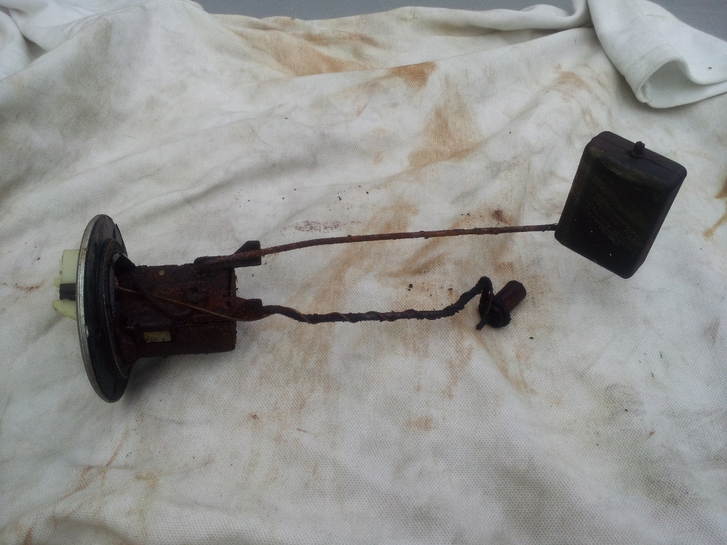

Thoughts on the sender? It looks bad, but upon tapping the body, the rust simply flaked off. I'm thinking of soaking it in evaporust, then testing it out before having to buy a new one.
- Strainer
- Strainer (1024x768).jpg (407.32 KiB) Viewed 2829 times
- Sender
- Sender (1024x768).jpg (474.74 KiB) Viewed 2829 times

that sender unit looks in a bad way, I'd dump it and get a good used one off ebay or Craigslist..... these senders are temperamental even when in good condition, that rusty sender looks like nothing but trouble..... it's worth changing the pick up pipe at the same time as they are very rusty too and all those rust particles will end up in your carb, even with a couple of inline filters, some of the fine particles will get through.

Is it 30 years old? A new pump is like £30. You want to push it home over £30 pump?
You could attach any old filter on the end of that pipe I reckon. Or go without. Presumably it's just there to stop the big chunks.

Re: FB Owner
ian65 wrote:Hi, welcome to the forum![]()
Thanks for the advice my friend!
