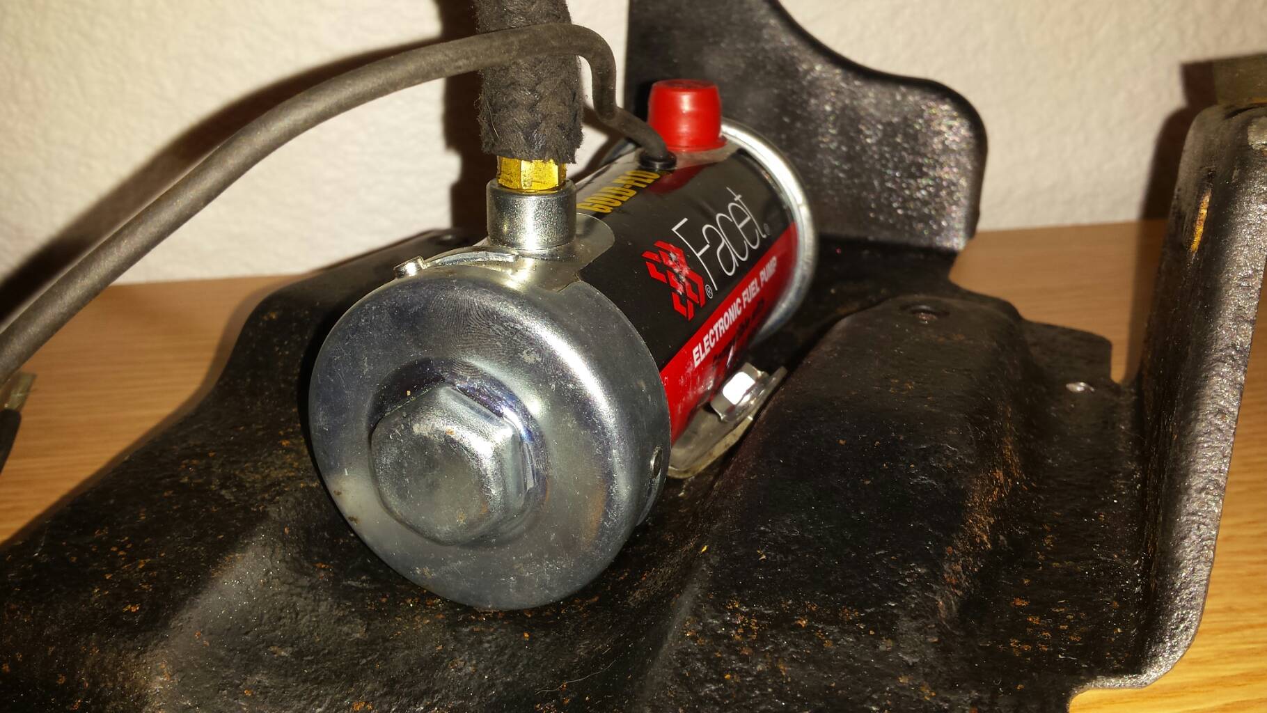

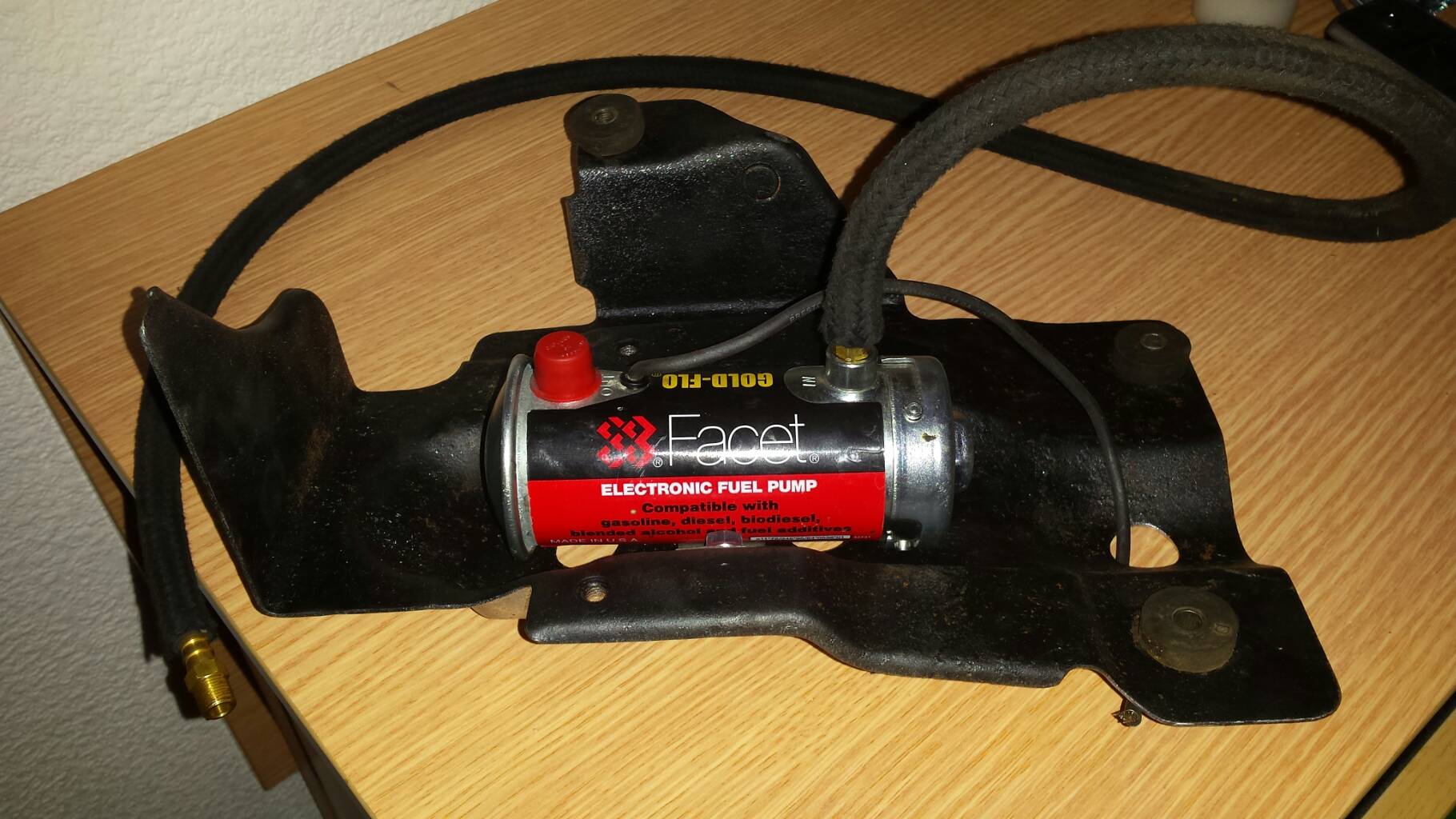

Anyone fitted one of these?
Not sure where to locate it because it doesn't fit well in the place of the original pump. :?
There are some mounting holes in the chassis rail where it could go but still far from ideal.
Any suggestions?

two brass elbows will sort it out. must be near the fuel tanks.
Many moon ago, i used two facet pumps to feed the I.D Rotors made 51.5mm weber on a PP motor. that was good..

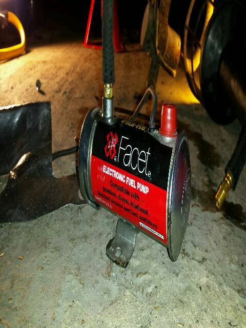

Good shout. I gently bent the fixing lugs to match the profile of the cover plate, drilled some holes and attached the pump. It seems to sit low enough that it should hopefully fit once I get the 90° fittings on it. If all goes to plan I'll fit it next weekend. th:
