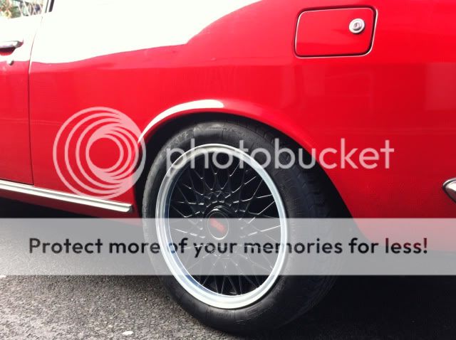

The only way you can buy shocks and get the ride height you want is to have custom springs made. I did this for my RX2 (yeah, good luck finding anything for one of those in the UK) and it was about £200 a set. I provided the old ones and had them stiffened, ride height lowered and full extension lengthened all at the same time.
They came out like this:
I agree with Ian about coilovers. Unnecessary on the street, unless youre trying to get the ride height exactly right with no guess work.
