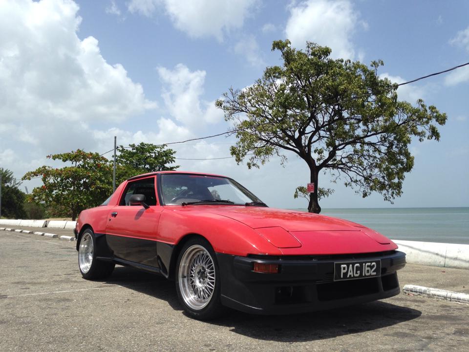

those were 15" elipsons (15x8+10 15x9+0), wouldn't have cleared brakes and IMHO just looked too small on the Mariah kit with modern tires.. 17's seem the way to go IMHO.. I'm gonne be ditching these cheap ebay wheels for some works wheels eventually.

they looked huge cause i got em with 295/60R15's on them.. :D
Now i'm running 17x8.5 +15 front and 17x10 +20 in the rear
OH and i am now looking back and I think you may have been referring to the 18" 5 star wheels (black with chrome lip)
those were off a FD, 18x9 +45 with like 2" spacers.. was only for rolling the car around with the big brakes and 5 lug already done, before i got the 17's.

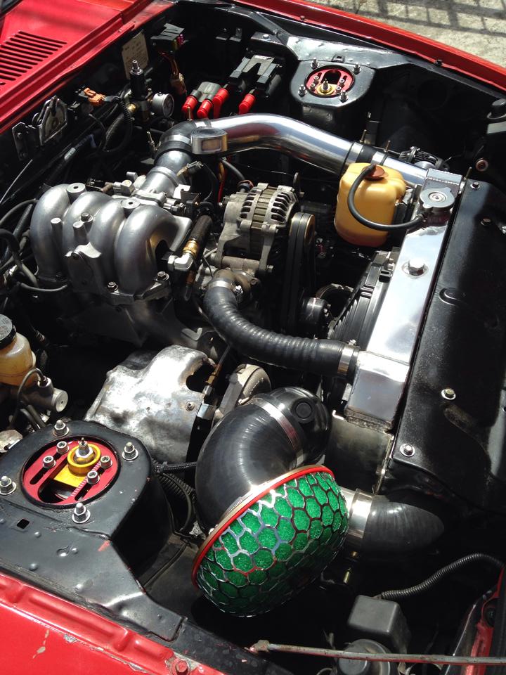

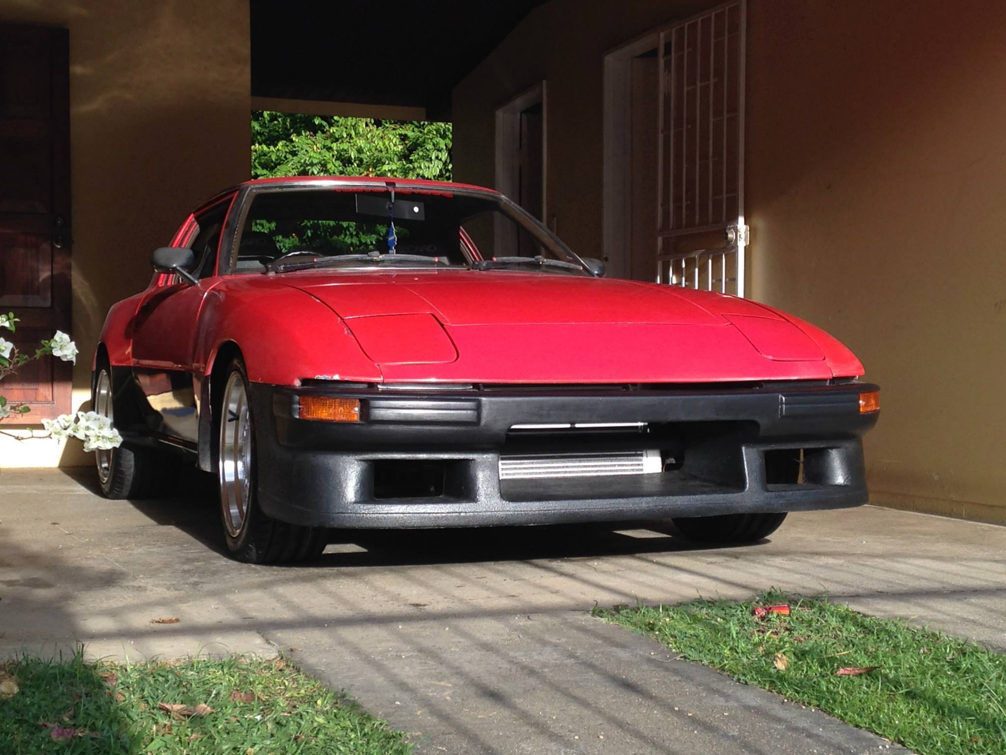

Hey! Just popping in :)
I'm just lovine the car! sine last post, i;ve installed a bunch of T3 parts and have lots and lots of parts to install,
hilux 4.1 diff with a eaton LSD to install,
FC rear disc brakes and callipers (new fc front callipers and pads waiting too)
a MR2 electric power steering pump & fluid cooler. (will try it with the stock power steering box, then do the s13 rear power mounted rack
water meth kit,
fuel cooler
T3 weld in LCA camber kit
T3 rear drop shackles
T3 rear lower/upper and watts adjustable linkages.
when all this is done (along with some electrical work), the car will finally get paint hopefully before easter :)
What color?
some recent-ish pics

Hi Aaron,
this is an awesome build.... I've been following it on RX7club.com........ top work! h:
I'm doing a S5 TII swap on my car and was thinking of flipping the turbo manifold to get it away from the steering box..... I saw that you thought about doing that too..... any reason why you didn't and bought the J2 manifold instead?
That J2 manifold looks really great, I'd love one of those..... how did you get on with the downpipe clearing the steering box, I remember that you were a bit concerned about it, any issues?
Finally, have you got any idling issues without running the BAC, did you mod the throttle body?
Sorry for all the questions but it's great to learn from your experience building this car..... inspirational stuff bud! s(c)
