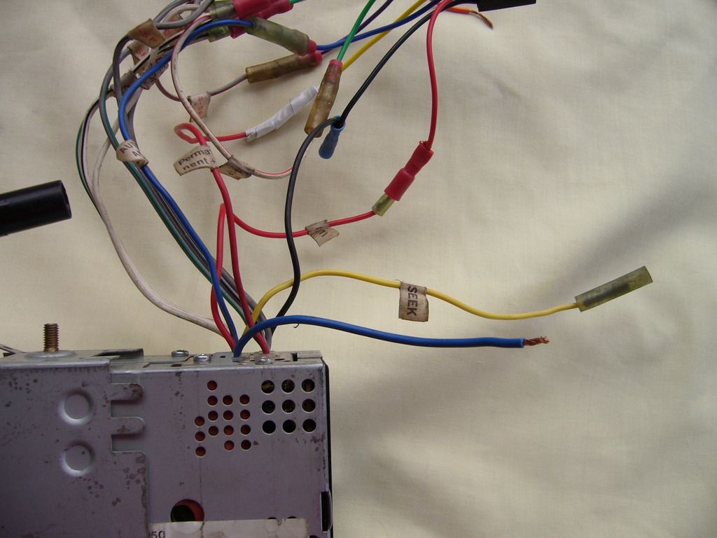

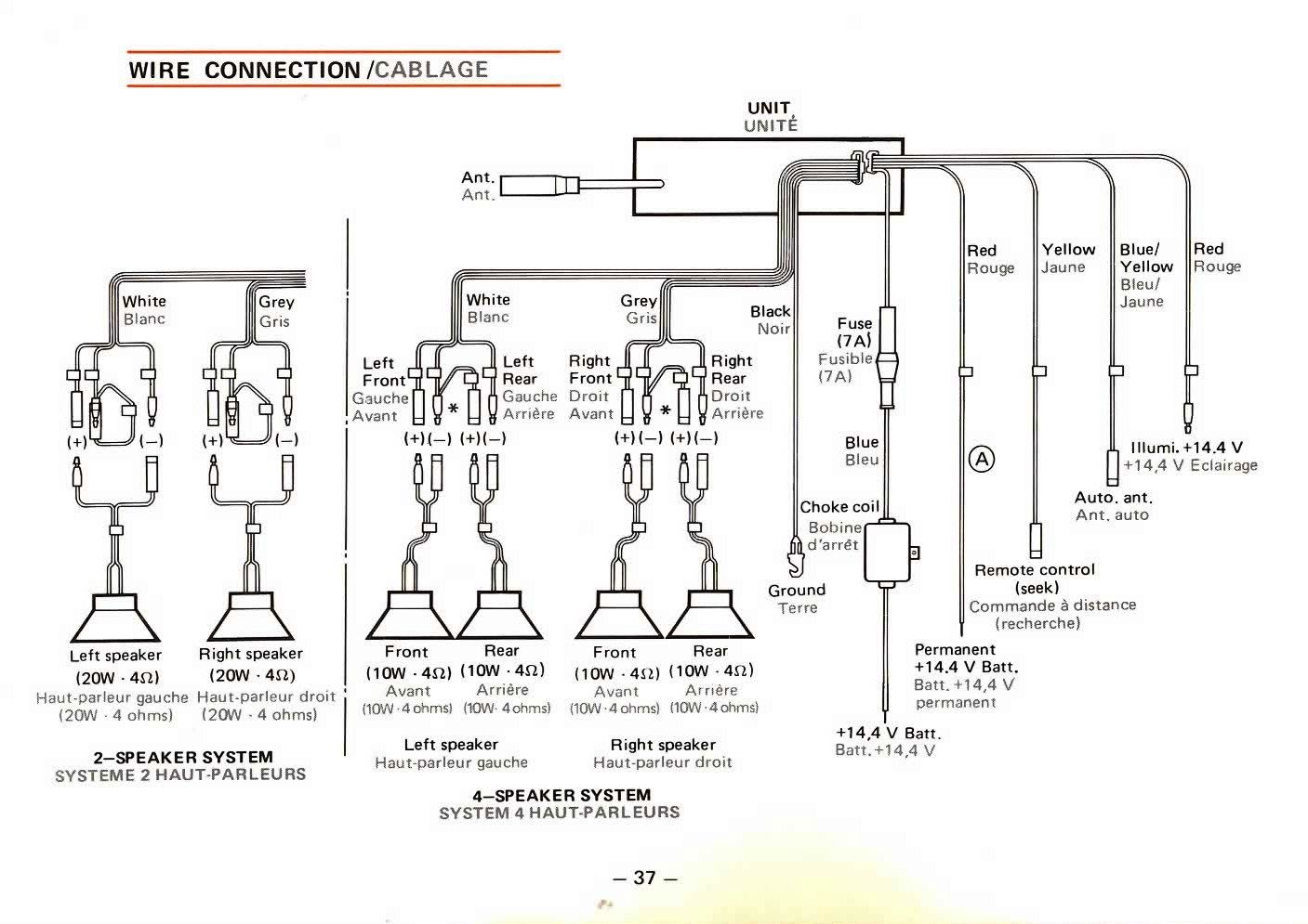

I am trying to identify the wires exiting from the original E950 Clarion R/C.
Some have labels (speakers conections) the others do not, some may be obvious but I do not want to guess the others.
Does anyone have a original User manual with wiring diagram (hp)

Thanks, I think its circa 1985 but pictures speak louder.........
It is the Yellow & Blue, I think the blue might be for a Graphic Equaliser, the yellow is marked "Seek"?
Re: Clarion E950 - original R/C - Wiring
DKWW2000 wrote:Thanks, I think its circa 1985 but pictures speak louder.........
Blue normally activate the power antenna
Seek Start remote control of the channel search normally an extern switch.
Yellow is the Input from the illumination Instruments.

Found this out...
looking at it, there are only 3 wires to worry about
Black = ground
Blue = switched live
Red = Permanent live
I've uploaded a pdf scan of this manual to my Google Drive, it can be viewed or downloaded form here...
