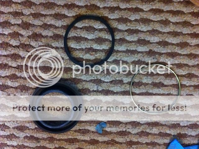

The dust seal is held in by a piece if wire. Here they are removed:
The outer recess is for the dust seal. The inner recess is for the main seal.
You can see the main seal in place and on it's way out.

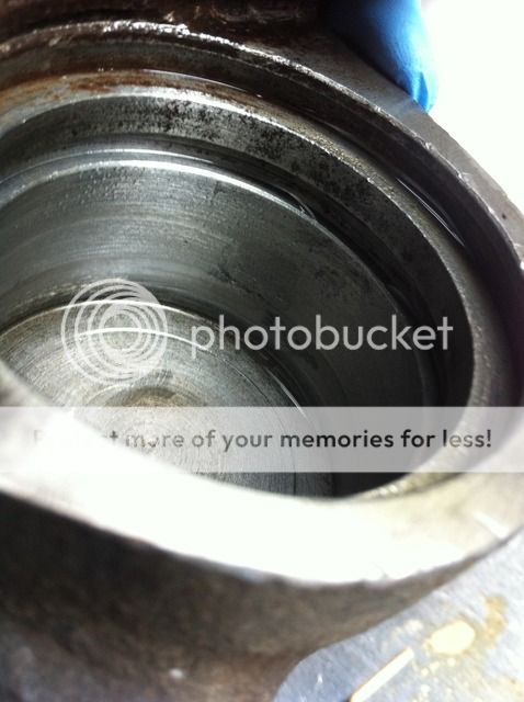

Cleaned up:
The damaged bore:
This isn't an issue as the bore only holds the piston in position. The seal is in the bore and seals against the piston, which is in good shape.
After running the hone over it:
The Girling repair kit
The remnants of the repair kit
The seals didn't fit properly and got pinched when I tried to put the piston back in. I'm not sure they were right as there was no part number on the box.
The dust seal ring also didn't fit well. I reused the old one.
NOS Mazda parts always fit. A big difference when putting it into the caliper.

Nice work though bro. I thought the damage was much worse when I saw that picture ha. Cleaned up well th:
