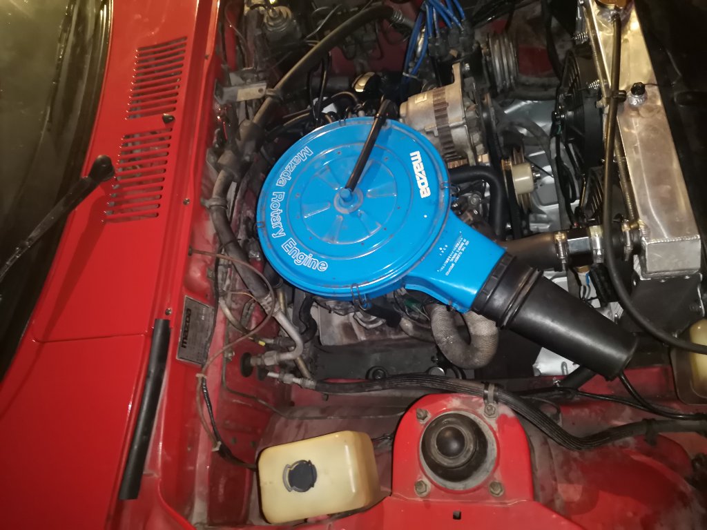

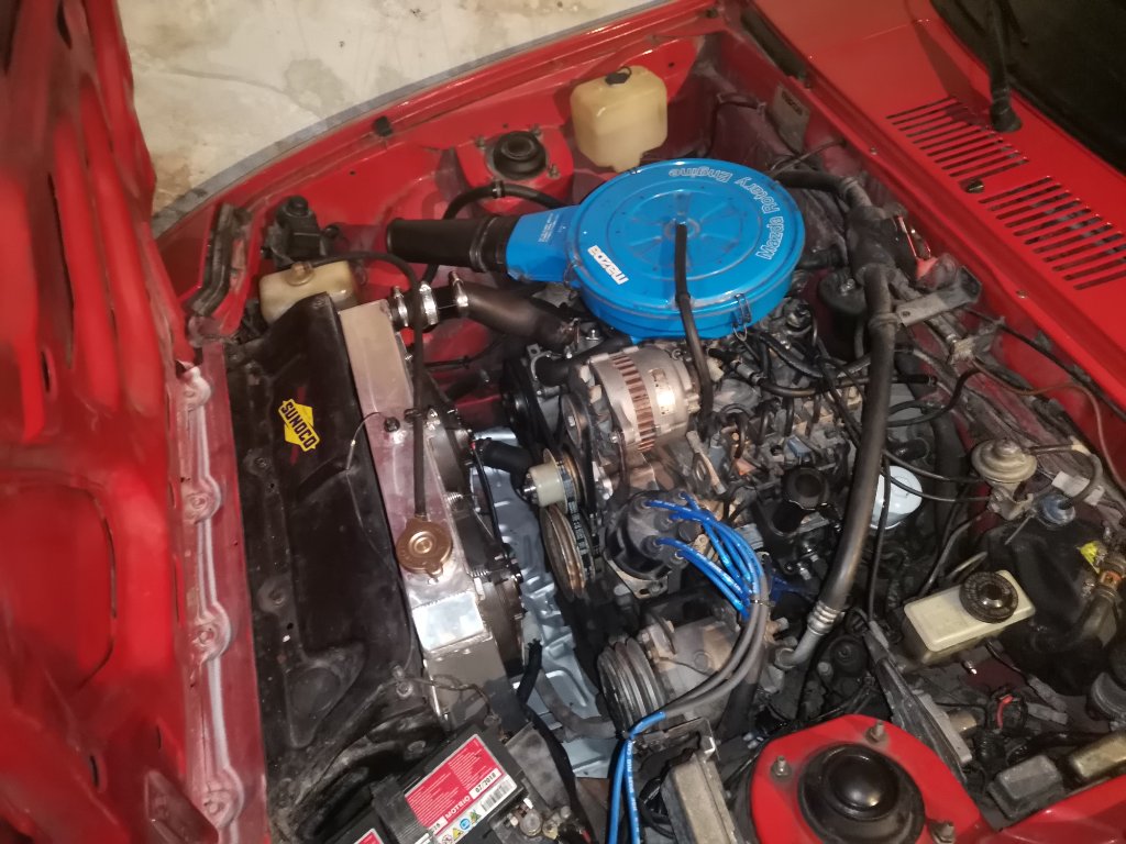

after all this work, the engine would start without any issues with barely any choke whatsoever (colds start) but would struggle a bit with warm starts (starting after 30 to 60 minutes of having turned the engine off); atm struggles with cold starts (half choke half gas) and it is a nightmare to do warm starts (half choke, full throttle will need about 5 to 10s of cranking, would not start otherwise)
maybe 12A hates premix? maybe the ignition coils are on it's way out? maybe the engine needs a rebuild?

Overhaulin the engine and carb isn't very difficult.We all are with you. I by myself like the very durable 12A. Check the housings and decide the route you will go.

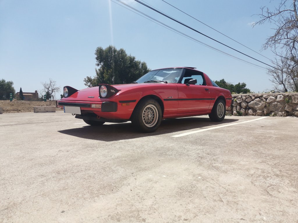

I am surprised the red colour normally shows more reaction with the sun. The car got a new paint?
Darkoyan
Posts: 2
Joined: Sat Aug 31, 2019 6:23 pm
Re: Greetings from Spain
Post by Darkoyan »
yes, it got repainted at some point, the color is the original one, although the paintjob looks good in picture is quite worn out. I will probably have to repaint it again, since it's a bit of a mess
