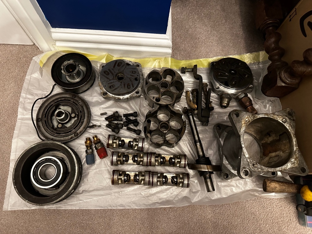

I’m in the process of rebuilding my Aircon compressor (Clarion F140)
I’m updating all the O-rings to allow the use of R134a gas but iv found the internal gaskets to be in a bit of a state.
I can’t find any suppliers.. so my question is.. is there any reason I couldn’t use gasket paper and a thin layer of heat and oil resistant high temp RTV ?
I can’t find any information stating either way
Any suggestions on another more suitable gasket material would be greatly appreciated!
Cheers all
Vic

I think I’m gonna give gasket paper and RTV a shot .. it’ll either work or it won’t 😂

What compressor oil you will take? Should be compatible to the new 134 a. A new elring paper should be enough, no rtv is needed.

Il be using PAG oil which is compatible with R134a
The old gasket is a thin layer of metal with a rubber coating .. to be safe I’m gonna use a very thin layer of RTV on the gasket paper.
You’re probably right and it would likely be fine with the gasket paper but I’m going to just add a bit for peace of mind

I personally like hylomar blue on paper gaskets or 3 bond RTV sealing metal to metal, not sure if either are compatible with A/C though.

So I got 99% success
It all cleaned up and went back together lovely. Topped up with PAG oil
However .. one of the brass connectors sheered off when torquing !
Hopefully I can use a reverse extractor tomorrow and get it back out without any brass debris getting inside the compressor. Otherwise it’s getting taken apart again 😂
