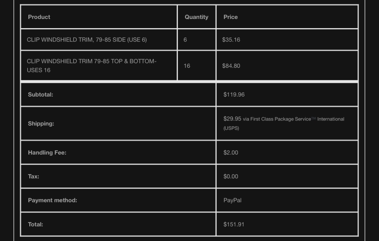

I got my clips from Mazdatrix. Not the cheapest by far.. but was painless to order and arrived pretty quickly
