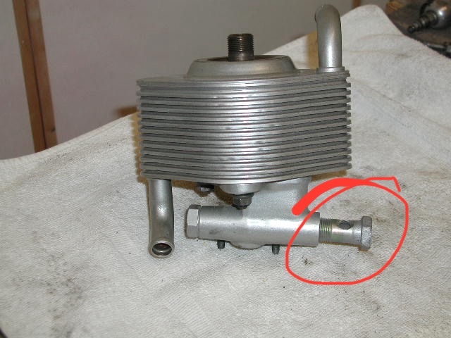

Thank you for your response .. that’s not quite what I’m looking for.. I have the adapters for the front and rear irons.. I’m looking for the thread on the banjo bolt of the oil connection on the beehive oil cooler. Il attach a picture of what I mean
Many thanks
Vic

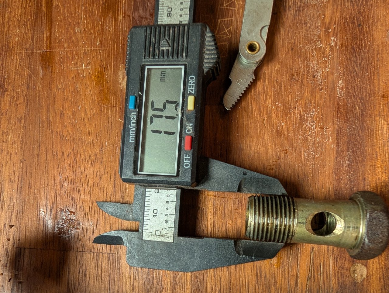

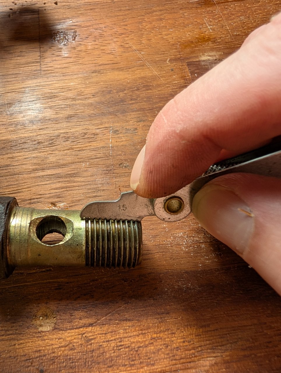

Ah apologies, just been out and measured it for you.
M18x1.5
