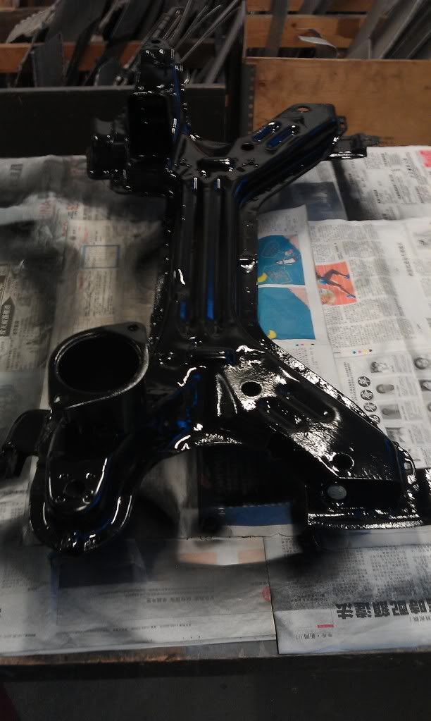

I agree with Rotaryguru, the Kurust stuff is great. I used it on the subframe of my Jetta and other metal parts. I first had the subframe media blasted clean of 20yrs of crud, paint and rust, then rust treated it with kurust.
[imgImage][/img]
which turned the surface black and blue
[imgImage][/img]
then cleaned it off and etch primed and zinc primed it
then final paint.
I did the same for my radiator cowl and other metal sections that are visible so I rubbed those down first then treated then flatted before priming and painting. Came up ok. Its been a year and no signs of rust coming back g-l
