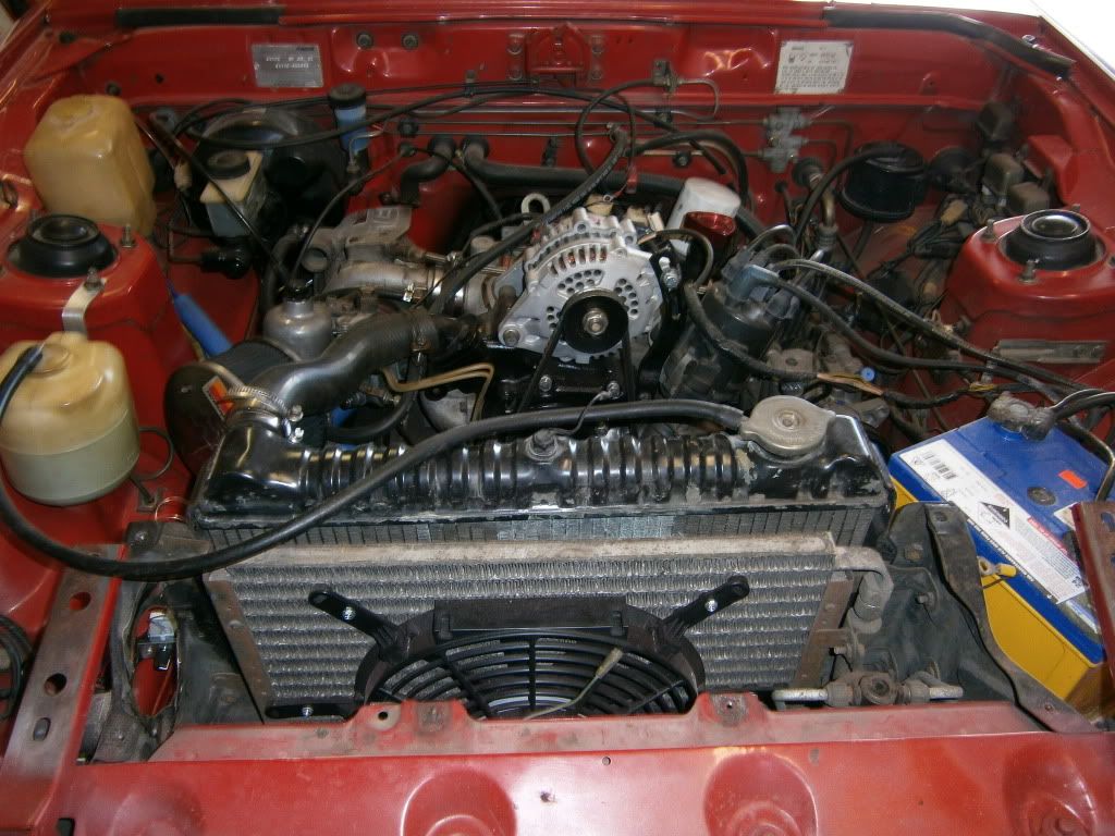

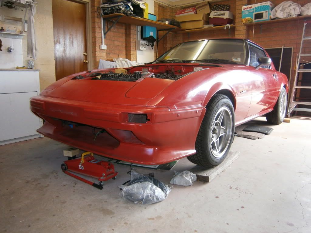

Re: Elford lives down under

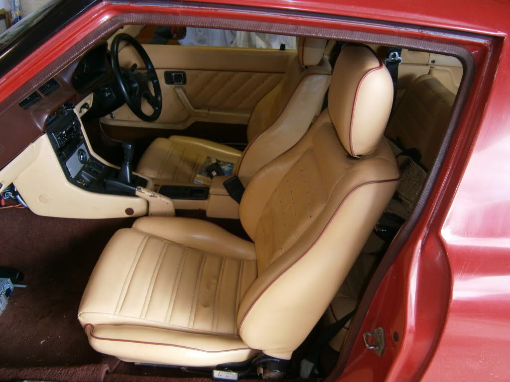

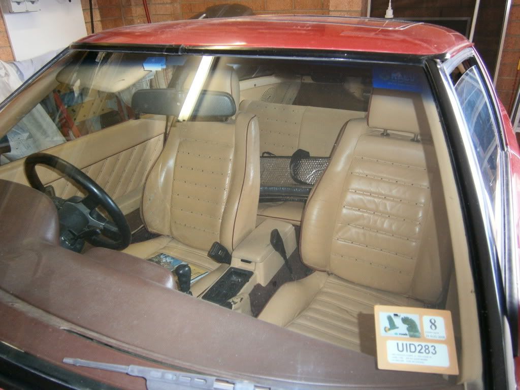

Wow, loving that interior. Is it real cow?
Want those mirrors, too, an' all 8-)

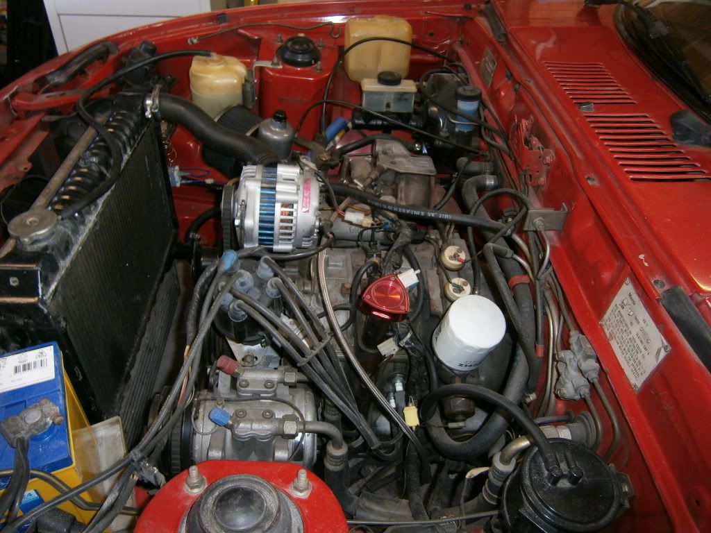

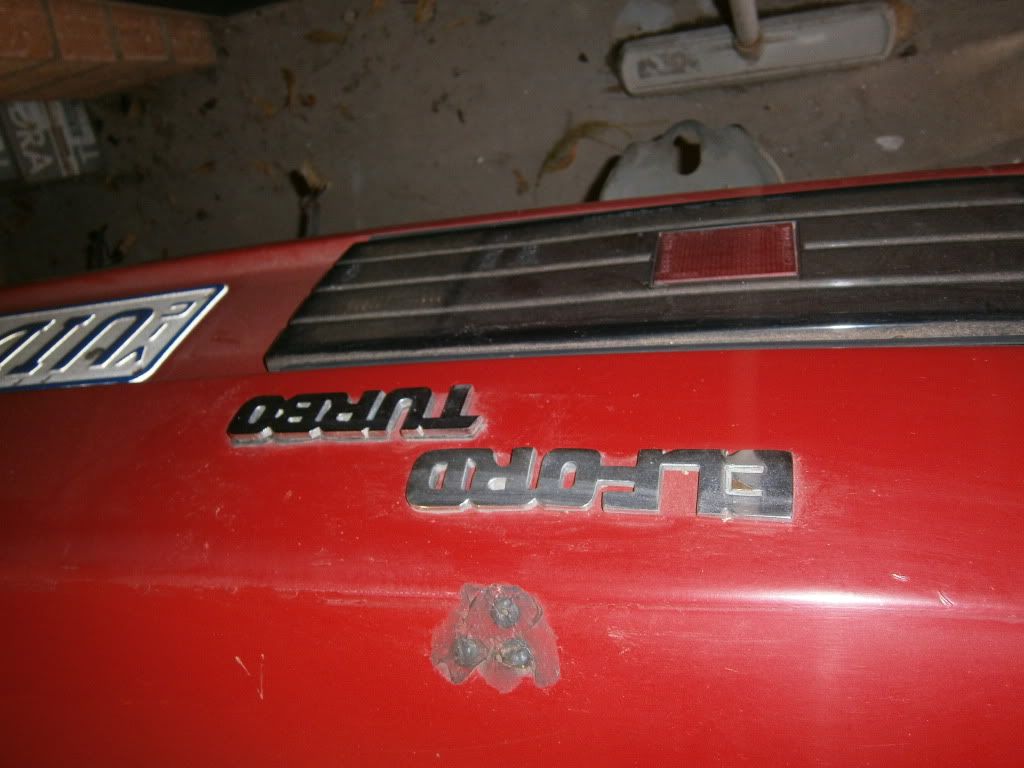

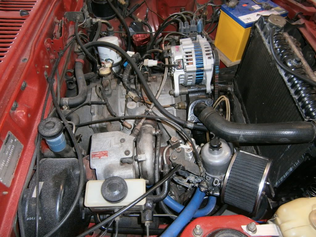

Great to see an Elford down under Ian, and still with its front spoiler as well.... I notice that the turbo cover has a red label, I've never seen one before, all the turbo labels I've ever seen are blue. The engine looks very clean, the car seems like it's been well lokked after.... nice one!

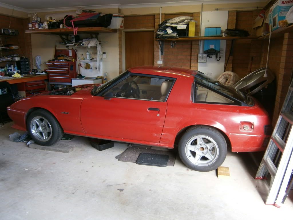

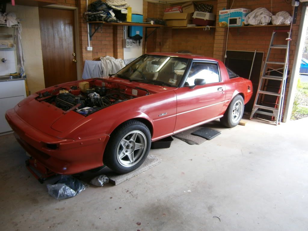

Thanks for the comments, it is a leather interior and in pretty good condition all round although a respray would do it justice when I can afford it !! I still have the Elford rear spoiler which has just been resprayed along with the rear bumper so when I get it moved around it the garage I will refit them, the turbo -turbo- is a recon unit when it was in the uk thats probably why the label is red, I have the original receipts and mot's which shows it had done 79000miles in 1989, the previous owner can't remember how many miles he covered but thinks 15000 ish, I have covered 15000kms since I bought it and the engine is still original, the wheels are 15 inch compomotive fh which came with the car from the UK, I have just modified the turbo oil return into the front cover as I was getting blow back through the breather when on boost an a lot of smoke from the exhaust, which I think was the oil getting past the seals in the turbo as it was not returning to the sump quick enough, I haven't been out for a run yet but now I have no breather problems as yet ! The electric cooling fan I have just fitted works with both the engine temp and when the A/C is on as the A/C wasn't cold enough when staionary and the viscous fan was only engaged if the engine was hot, the fan works great in the garage and keeps the engine temp just right, I have just bought a fast idle solenoid to assist when the A/C comes on when idling, it nearly stalls the engine with the load, so will be fitting that soon !, also bought a remote central locking kit from the UK, Rightclick is the company and it seems to be the best kit I have seen on the market as it comes with a new flip out key fob and separate remote boot release, I will keep you posted as things progress.
Thanks again for the comments, must go now as its beer o clock in Melbourne !! 0-0
