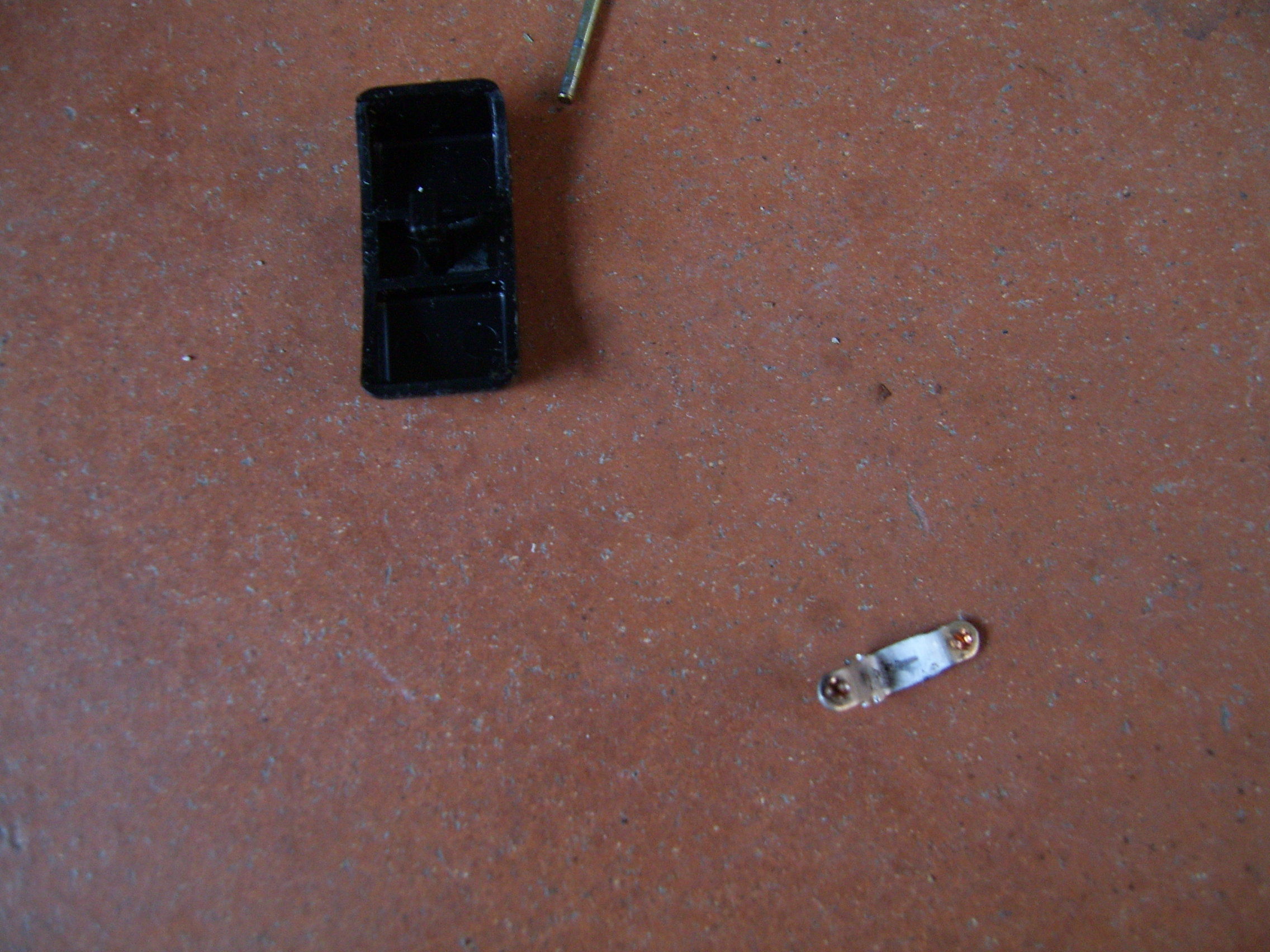

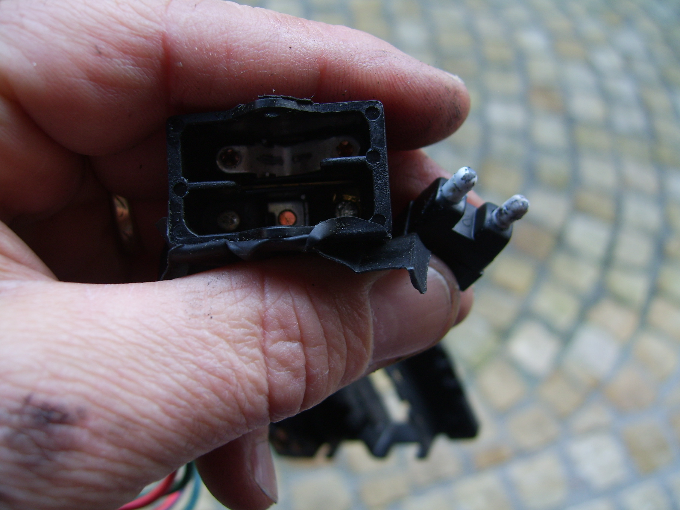

don't try and prise the rocker out of the switch body, go in from the bottom and take the base of the switch off..... be careful when you re-assemble it because it should only go together one way round but is easy to force the clips and re-fit the base plate back to front...... apart from that, it's a piece of cake.

The problem is the fluff and crud that accumulates in there. It is like the belly button of the RX& interior.
