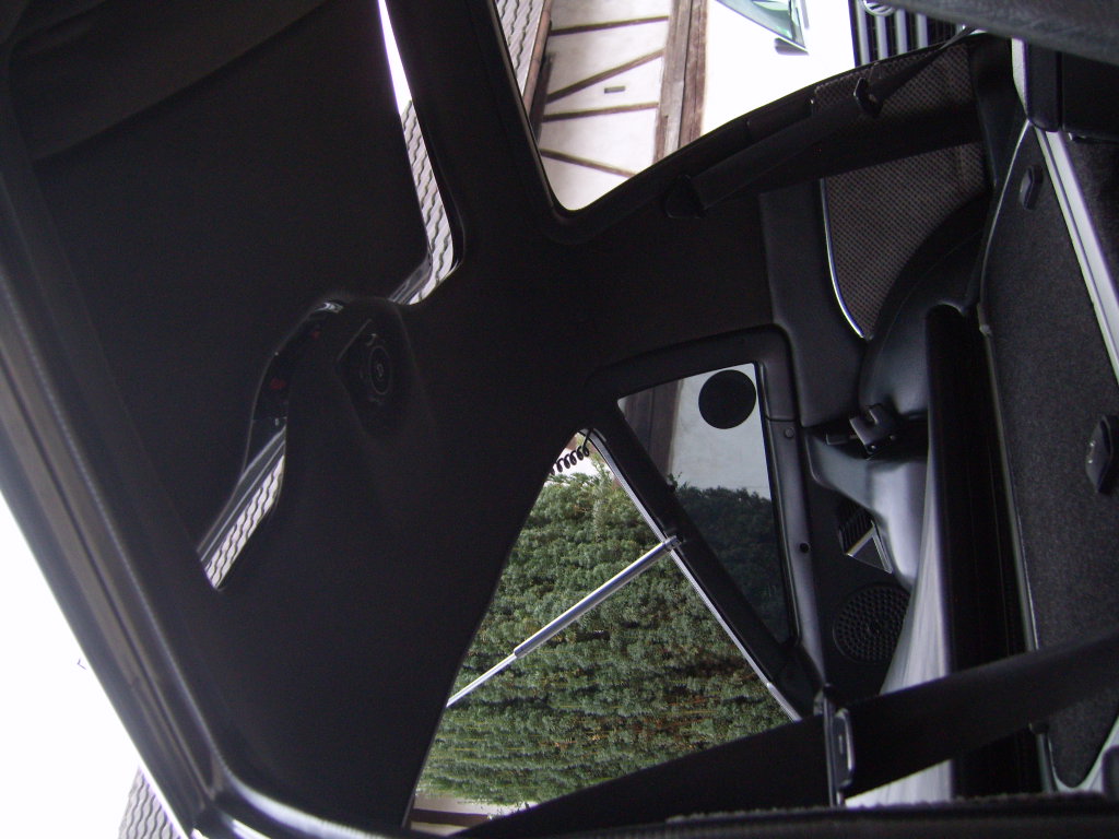

Very cool pics they show a lot of brainstorming was working. Timeless colour is my favorite too and is perfect for turbo because the SA22c GTX have the same and all over the world the people like "gunmetal" painted fast cars.
All over the years I take a lot of new parts from mazda but they doesn´t work if it is cold. The parts fom USA Rotaryfactory I got 2011 are fantastic. I buy two (left and right) but only need the left one for excellent working.
The left you see on the picture is Rotaryfactory made
