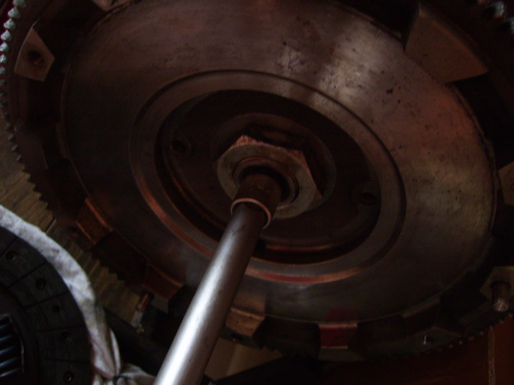

myatt1972 wrote:As Dave says there is a hidden bolt behind the starter motor other than that pretty straight forward.
I have got a sawn off g/box input shaft if you want to borrow it to centralise the friction plate.
Engine bay is looking great in those pics s(c)
Thanks for the offer of the shaft but should be OK thanks,
Pete
Re: RX7 SPOTTED ON DARTMOOR
In addition to what's been mentioned, there are 2 bolts which are not threaded all the way up and are a bit longer iirc. These need to go back into the correct holes on the flywheel.
Also, your clutch is for a S3, which is 225mm not 215mm like in the S1 and S2. Make sure you get the right one.
Pete check your main bearing of the gearbox. Easy to pull of with two long bolts from the gearbox and the the small part from the gearbox mounting brackets.
I run closed bearings instead of open from mazda. S3 box. (your biggest catch isn´t the fish in spain it´s your car s(c) :) )
myatt1972 wrote:I have got a sawn off g/box input shaft if you want to borrow it to centralise the friction plate.)
nut + lengthening . ;s;
Clutch all fitted, no real problems. Friction plate down to rivets :!: :!: Only thing to do is adjust the Pedal back to Standard setting which is probably the hardest part as it is sod to get at if your not made of rubber :lol:
A lot of wear after only 58K, perhaps a previous owner had a heavy foot or liked drifting.
Thanks everyone for help & info, proved most useful,
