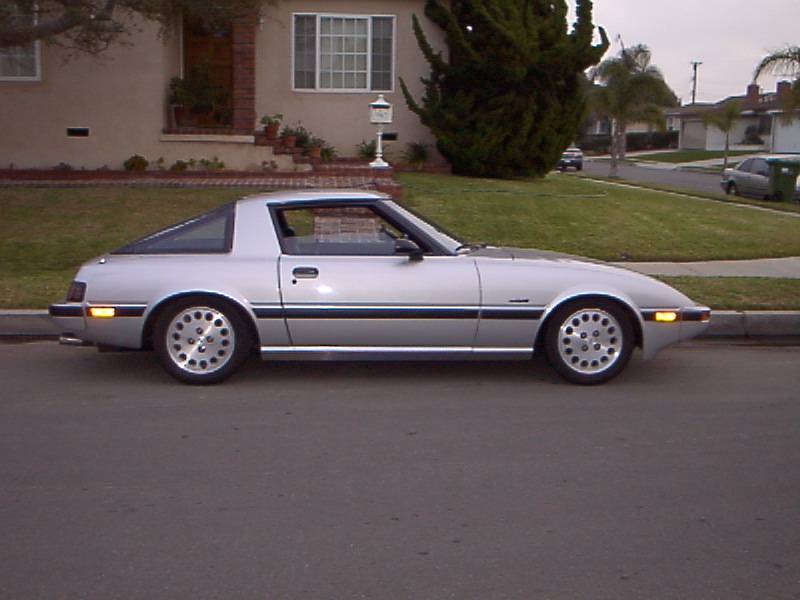

Hi.
I have a completely standard 1984 rx7.
I want to lower it so the top of the tyres sit level with the top of the wheel arches front and rear. Car must sit level as per below pic.
Car is for street use.
Comments and advice much appreciated.
