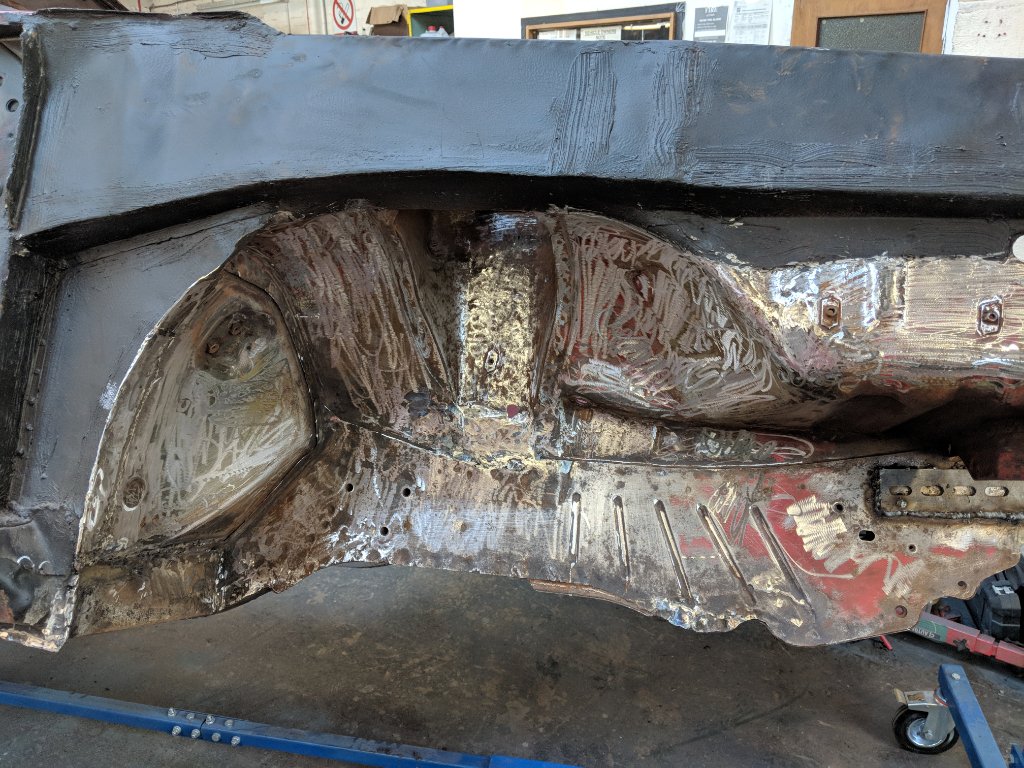

I'm going to smooth the wheel wells with fiberglass putty, so basically I would normally put a zinc primer down and then a underseal to provide a tough durable coat for the wheel well. But as this isn't going to be a daily driver or ever used in the wet I'm totally smoothing the wells and using seam sealer and then will paint over with a 2k hi build primer and then paint them the same colour as the bodywork which should look great. Plus I'd like the wilwood big brake kit and the ACBRON coilovers to standout and there's nothing worse than a messy wheel well whilst admiring a nice set of calipers and coilovers! So today I spent a good few hours stripping down the Right hand wheel well and grinding the welds down from Saturday night/Sunday morning. Took alot of the underal off too - I'm glad I did as someone previously had painted it over rust, good thinking batman.
Will update tomorrow when it's fully stripped.

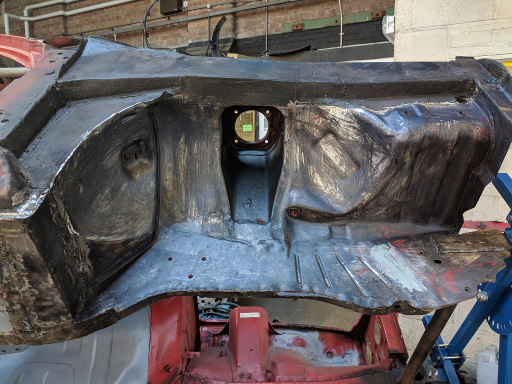

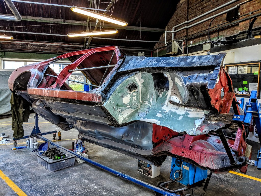

Here's the wheel well

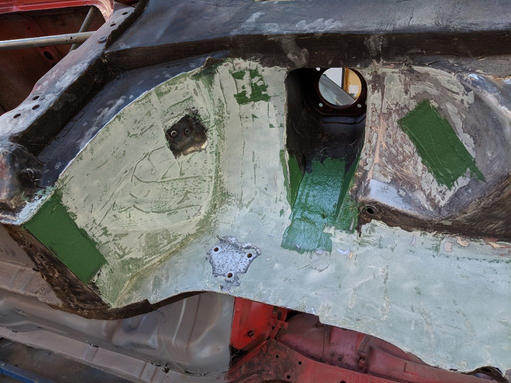

So applied the first skim of fiberglass, not too hard to work with, sands easy enough but makes a mess. Spent about 4 hours sanding it down today and it still looks rubbish but it will untill the body filler goes on top of it!
Sanded and applied more to areas in need on first skim
First skim
First skim
Before
Before

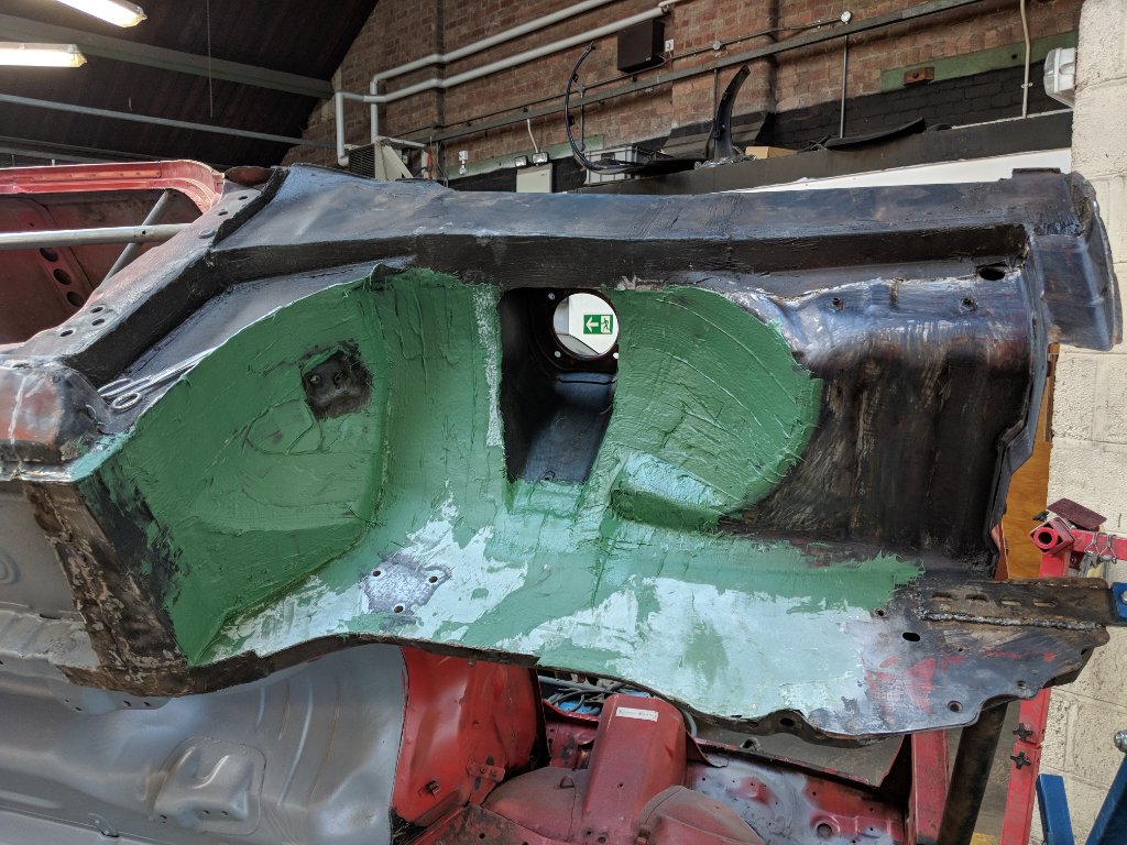

Got off work at 1100 today so had plenty of time to sand away the fiberglass. Took me six hours but the results are worth it!
I had to do three skims of FBG in the end as there was more air bubbles than I anticipated as the card wasn't that flexible and due to the curvature of the well I couldn't get if perfect in some spots!
Applied the deep repair body filler ontop of the places that had low spots ect and sanded away....
And yes that is a blister on my finger from sanding lol

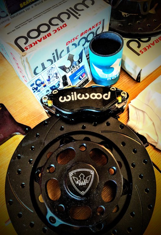

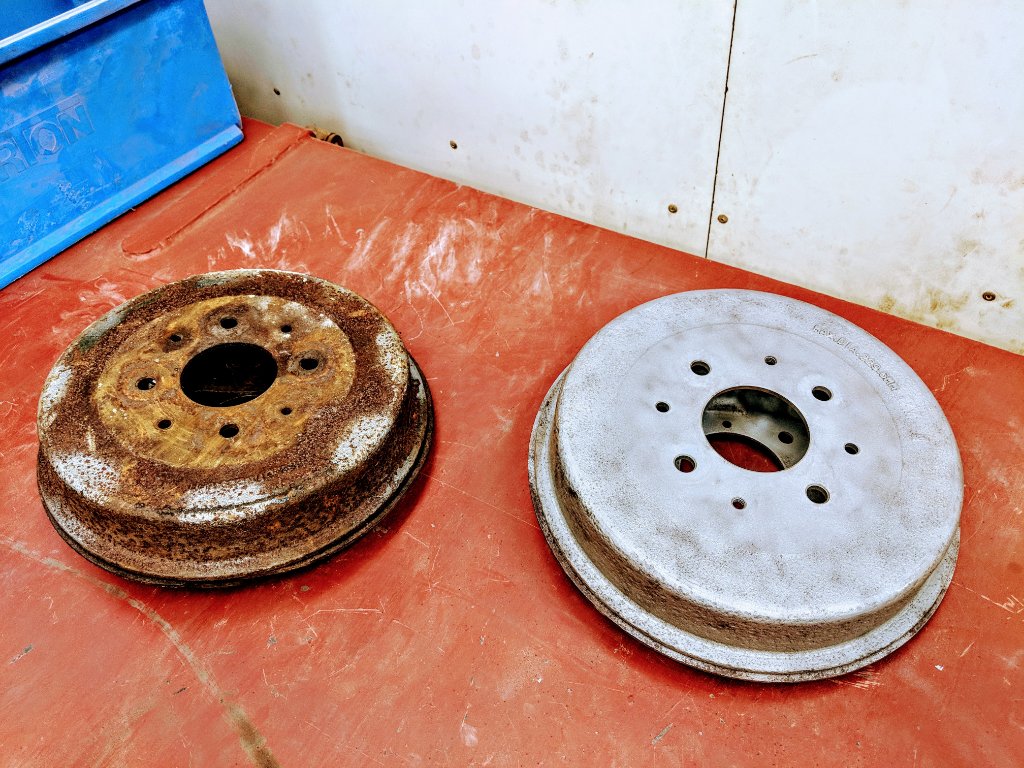

Did some sandblasting today and was able to blasting both sets of drum brakes, going to paint them tomorrow and I'm just waiting for the little clips and bits to come so I can rebuild them.
Aaannnnnnd my 11" wilwood brake setup came today with billet hubs and everything. How preeeeetyyyy are they?! Very happy with them! My acbron coilovers and kyb rear dampners are comming in the next few days too.

I think I’ve got some NOS drums for that. What size are they?

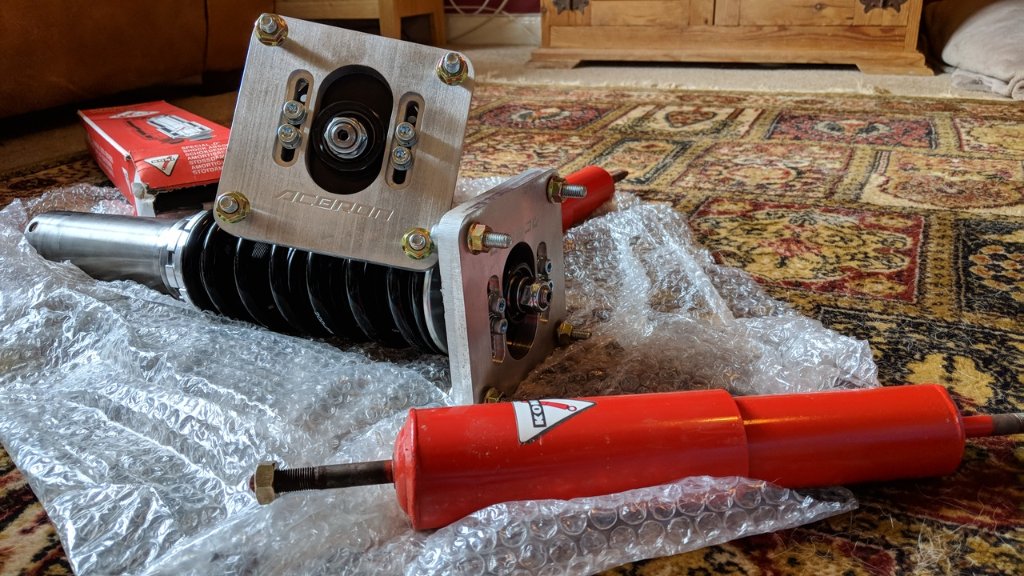

Completed the rest of the welding today and safe to say it's getting better that's for sure!! In other news my ACBRON coilovers and KONI rear dampners have arrived and look awesome! Gearbox is ready to pick up tomorrow (service and replaced gaskets).

Re: 1975 RX-4 SEDAN - BUILD THREAD - SCABSY
If they’re old stock Koni’s they’ll need rebuilt before you use them.
