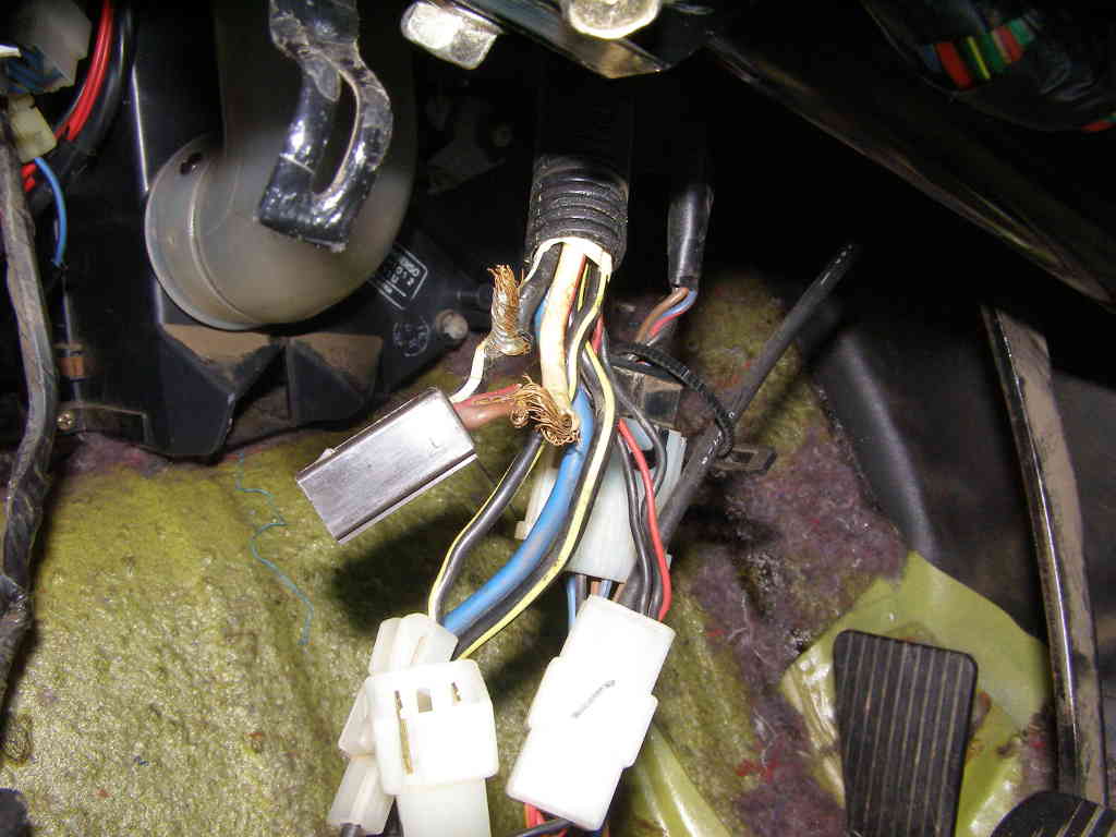

Here's an example why the wiring system upgrade took some 30 hours more than it should have (and I found this sort of thing in more places than I could credit).
I hope no-one else finds anything like this.
Amazing, the auto electrician who worked on the car actually left his business card in the glove box!!

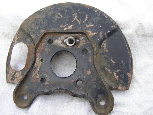

It's been lomg getting this done but som update pics from early
Sensor and sensor mount in front caliper plate.
sensor mount.jpg (60.12 KiB) Viewed 51115 times

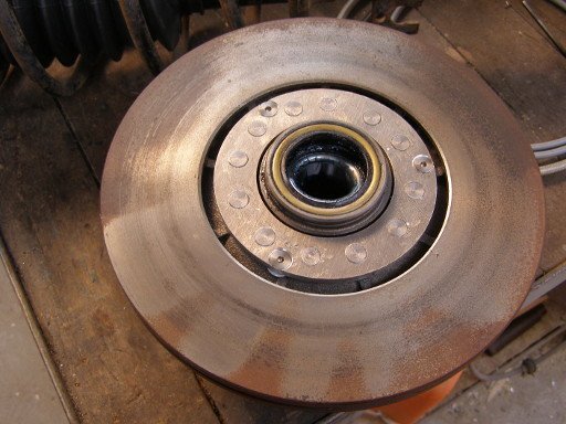

and the first version of the disc inside the front hub, steel inserts in aluminium plate
which proved to be totally unsuccessful!
Email to Brantz got the needed info, turns out their sensor also detects aluminium
The sensor needs 14mm or wider metal target, preferably iron.
Unfortunately no pic of final version but changed to plain steel plate with 9 holes 14mm diameter, so about 15.9mm between holes
Now works and Brantz are updating their docos to give better info.

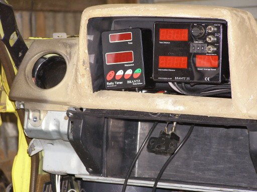

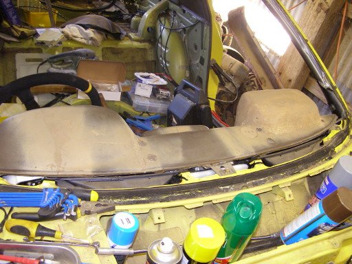

These were when I was modifying the dash.
The housing over the trip meter and clock is constructed with 1mm thick ABS plastic sheet (styrene) and covered with sprayed on impact foam.
The meters sre mounted on a concertina fold aluminium bracket from the upper steel area of the original dash shell so it will collapse if ever impated.

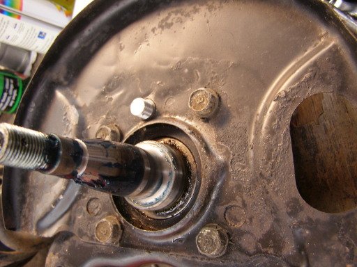

The front wheel sensor disc
