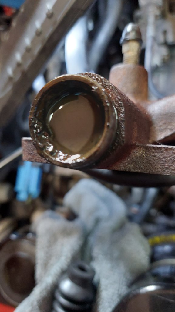

My planned trip in KIMI 3 to JDM Combe last Saturday had to be abandoned. Reason? With the car cleaned to within an inch of it's life and fully packed, I started her up and engaged reverse, to be greeted with crunch. Darn, the clutch bite point had sunk to the floor. Suspecting the clutch slave, I had no time to fix it, so I transferred all the gear over to my RX-8 and took that instead!
I've just got around to taking a look and, as usual, a visual inspection of the slave in situ revealed nothing, but the arm travel was about half what it ought to be.
Slave unbolted and rubber boot removed, viola, failed slave seal!
Knowing how these slaves have a habit of failing, I had previously ordered not one, but two new slaves from RockAuto on previous orders!
So, job for later is to fit and bleed the new slave. I'll bench bleed the slave before fitting too.

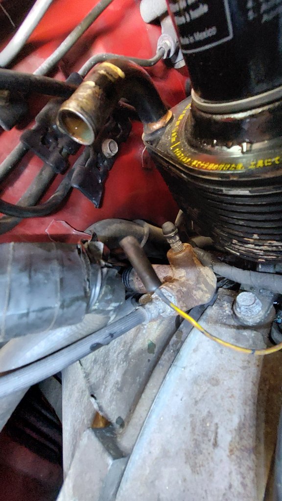

Whilst I was removing the slave, I spotted this wire nearby, emerging from the loom that runs behind the beehive. Should it be connected anywhere?
Re: KIMI 3 - 1984 Series 3
Sensor right side picture
Looks like the water Temp sensor, sensor has a round bullet type connector that it would slip over.

Thanks guys, that was my first thought, but my water temp gauge is operating normally. I'll take another look and see if the temp sensor has got a wire attached though!
Great news, new clutch slave fitted and all is good! I used the "piston block" method to bleed the slave using a "G" clamp to keep the piston from moving. Worked a treat. I flushed the clean, but dark looking old fluid out completely. I now have a fancy electronic "pen" brake fluid tester on order from AliExpress - spotted it was £2.30 with free delivery if I ordered about £5 worth of gear. I have to wait a few weeks, but a useful addition to the toolkit!
Good job I had 2 slaves on the shelf. Both looked fine, but one had a coarser thread for the flexi-pipe, so no good. Other one was fine. Two different brands from Rock Auto!

Would be interested to have a pic of your temp sensor cable as mine looks the same colour as your disconnected wire,
