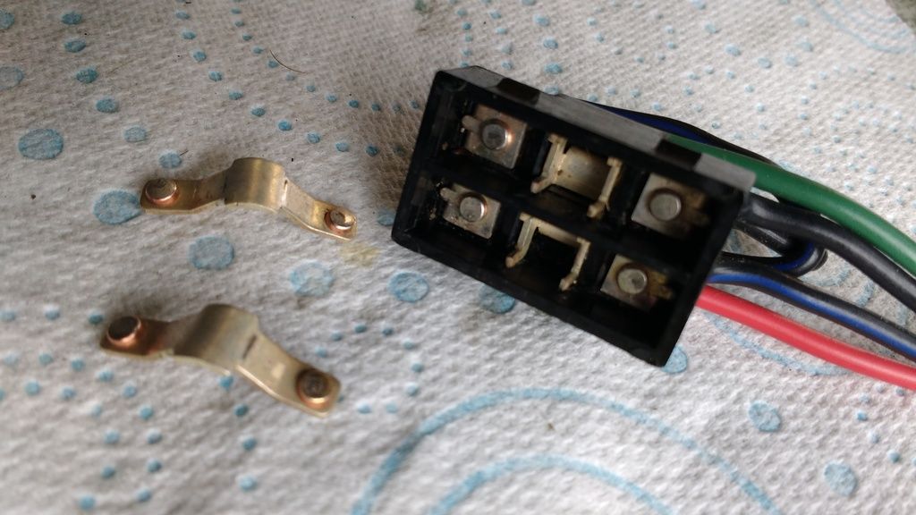

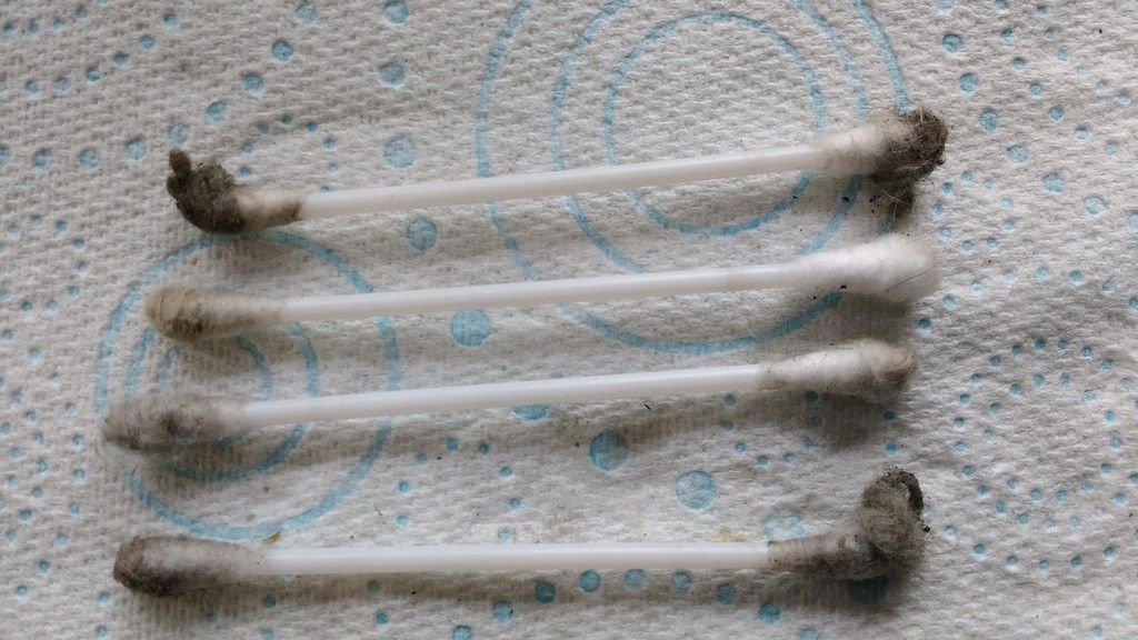

My driver side window stuck in the fully down position this morning :( Thankfully it wasn't raining and I was only a few miles from home. I know the switches have been noted as becoming intermittent so I found this thread on a search. Many thanks to those who have trodden this path before me and posted above, as reading through this thread made the job soooo much easier. 45 minutes later and both switches out, dismantled, cleaned, back in and tested fine yay
Some pics for the record (4 cotton buds gave up their lives for the success of this mission :D )
