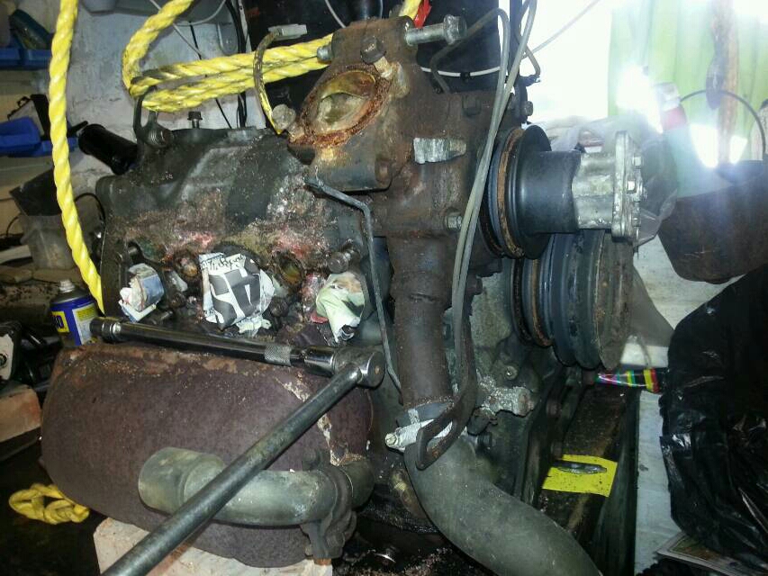

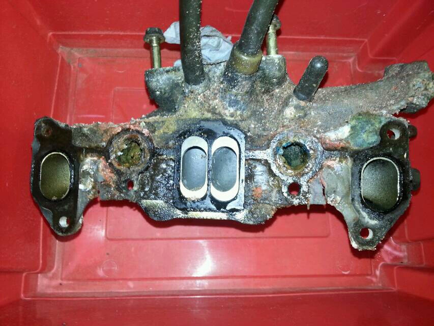

Ok managed to get the inlet off, and YUK! Its a mess... the o-rings crumbled when I took the manifold off so definitely failed :p the gasket doesnt look at its best either.

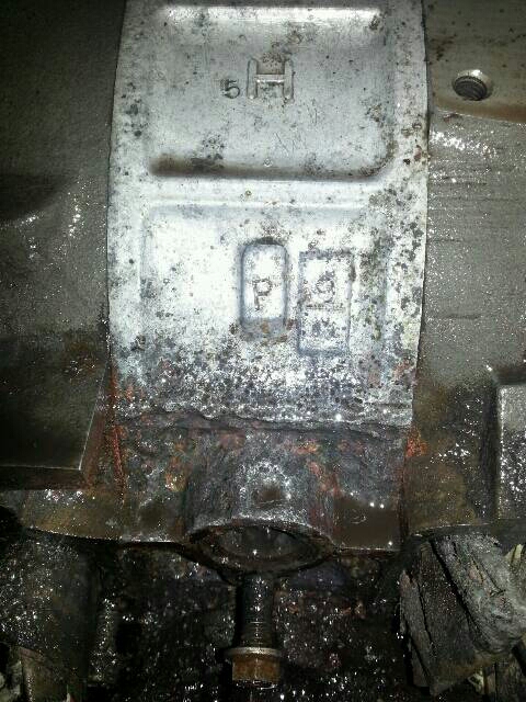

I had a clean up of the iron around the area and I'm not too sure on the condition, its really tough to identify whats the block and whats baked on coolant.

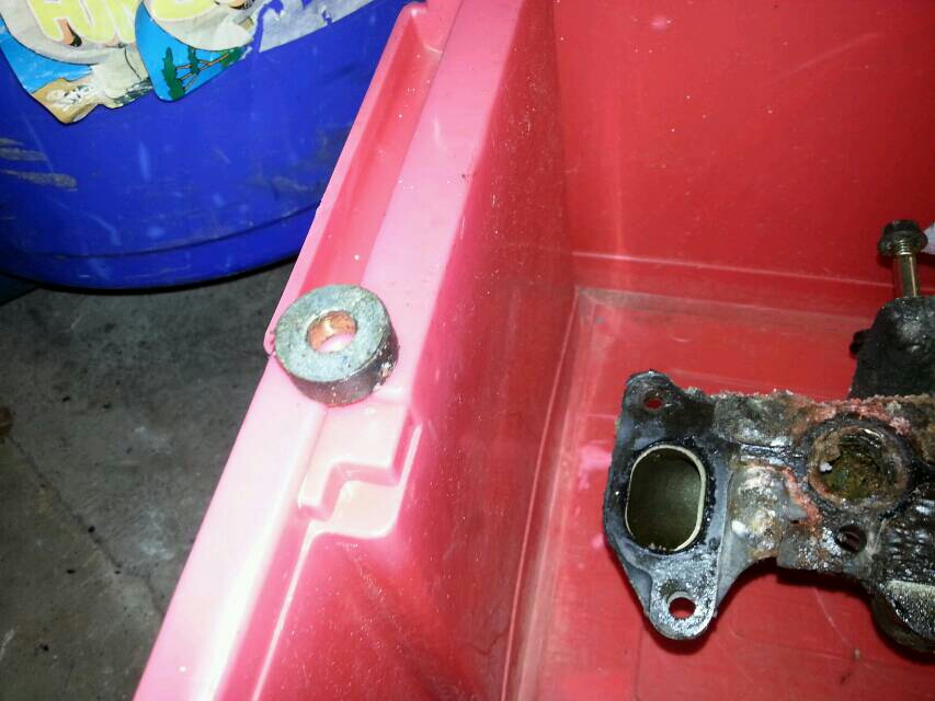

Finally when I took off the inlet I found thos spacer ontop of the thermo reactor, does it belong on the inlet somewhere or has it just fallen and landed here previously?
Finally finally trying to remove the waterpump housing from the front of the engine, is their an easy way or does the main pully have to come off with that large bolt in the middle of the pully...?

Random spacer found, can anyone identify where it should be? (hp) ...
Inlet manifold NEEDS CLEANED! :O

What do you think of the condition? I think I cleared most of it fron the rear iron, but the pitting is worrying me :s

Re: cooling system refresh....
Yeah, that's goosed.
Spacer goes on the alternator mount with the bolt going through it by the looks of it.

Holy cow, that inlet mani looks like it's been dragged up from the bottom of the sea :shock: Did you actually find any barnacles? :?

You'll not be leaving the thermal reactor on are you Rich. If not I should whistle it off now, on the bench, before you put the inlet manifold back?
If you put the inlet back first, the top left bolt on the reactor is the worst access of any bolt, on any car, anywhere.
Dunno what to say about the corrosion. Someones really messed up on their cooling system maintenance.
What's your alternatives? paste it all up with gasket sealant and hope for the best? Or what else?
