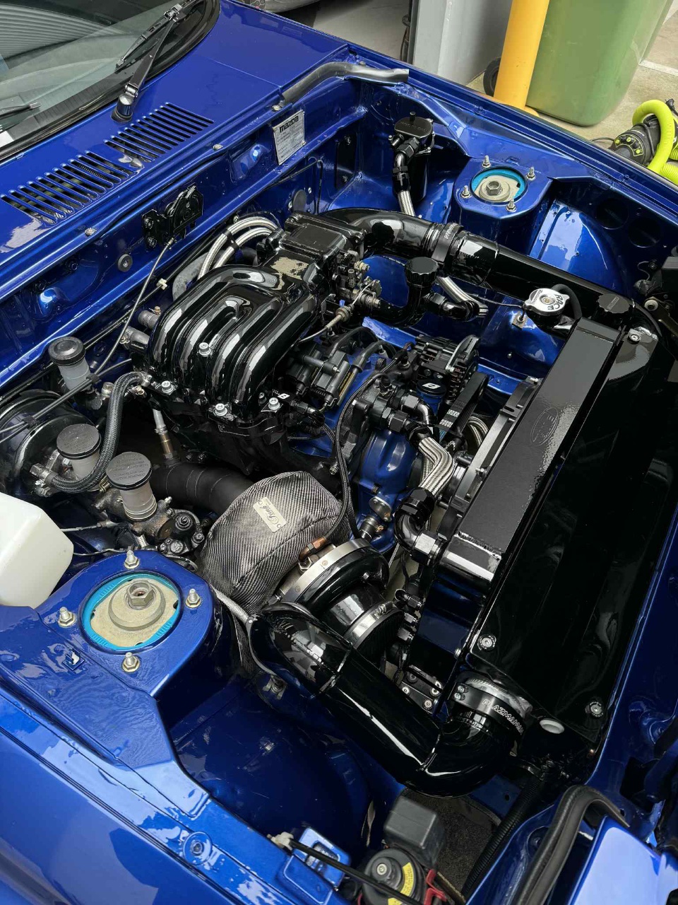

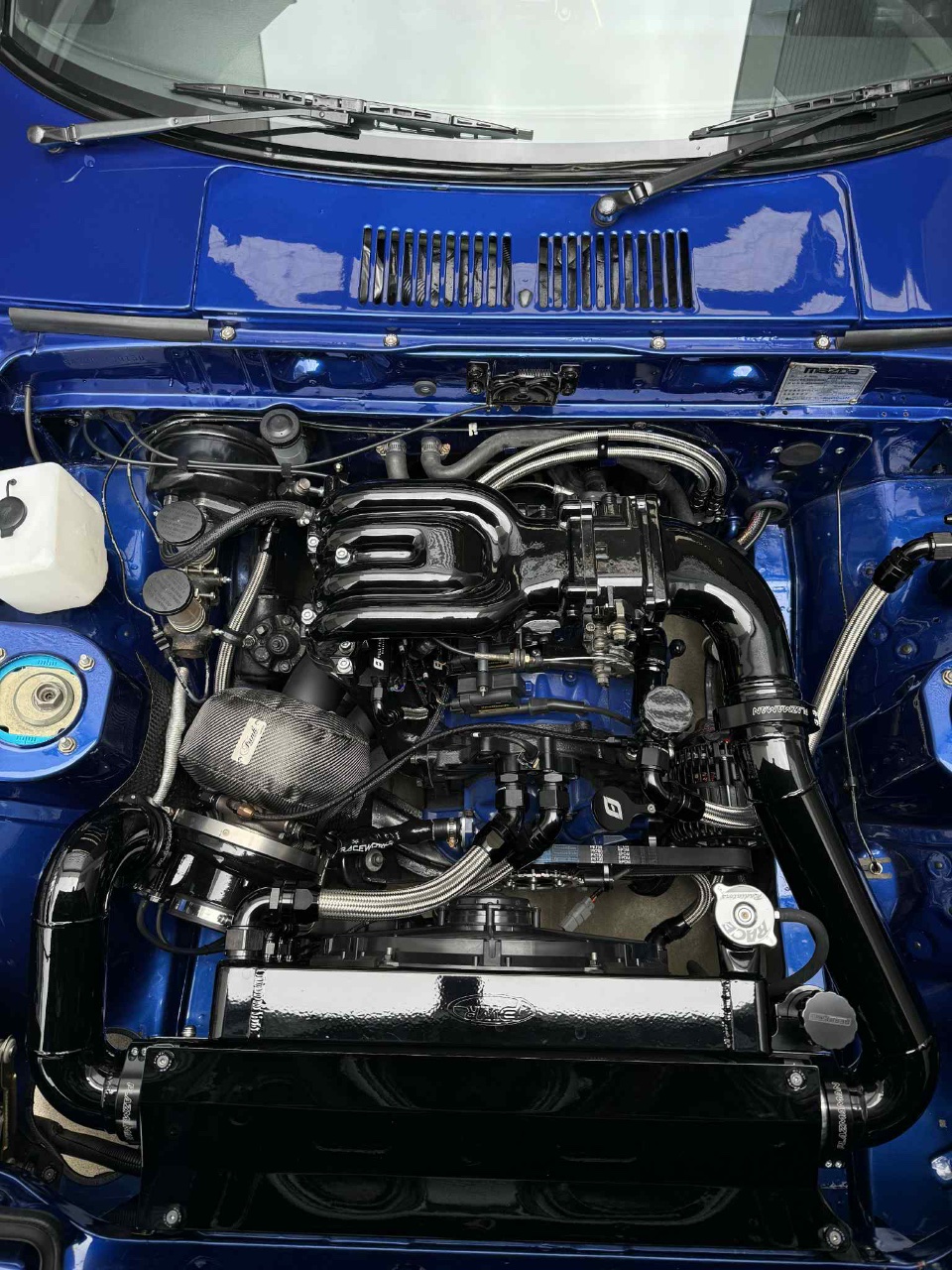

Project still ticking along slowly, upgrade a certain thing which then leads another part to be upgraded and so . A list of bits added so far full function fuel rail, haltech ignition coils ign1a, custom hak fabrication fuel tank , flex fuel , new hard line 3/8 fuel lines, ewp mounted directly onto lower outlet of pwr radiator, new turbo purchased Borg Warner Efr 8474, Turbosmart FPR6, haltech UC-10 dash and canbus button pad. Raceworks billet fuel filter, and more than I can’t remember.

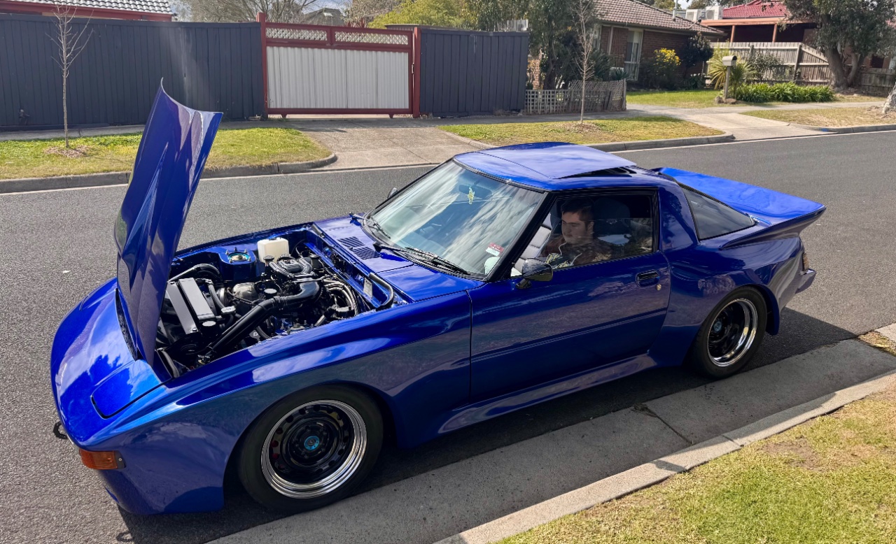

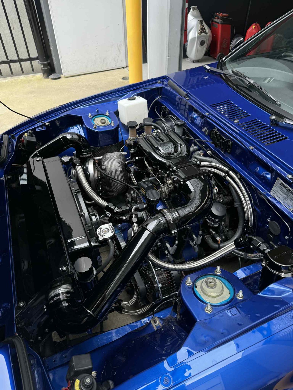

Okay it’s finally all done and back at home.

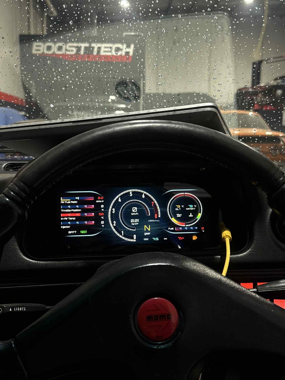

280kw at wheels on safe tune 98. Drives and starts awesome. Dash is great also, have 3 different displays I’ve been flicking through. Going to re work the Centre fascia now as so many holes from the 4 51mm gauges I had in it previously. Some interior tidy up, and then maybe over Xmas break work out a cold air box . Enjoy the pics .

Looks amazing! What lower intake manifold is that to get the FD upper?
Posts: 1949
Has thanked: 441 times
Been thanked: 181 times
Re: Daytona RX7
Hellramsden wrote: Fri Sep 19, 2025 12:26 pm Looks amazing! What lower intake manifold is that to get the FD upper?
Looks to me like a Franklin Performance adapter from NZ aye
Some pretty slick upgrades there aye! Is that the new UC10 dash? That looks mint aye :o
