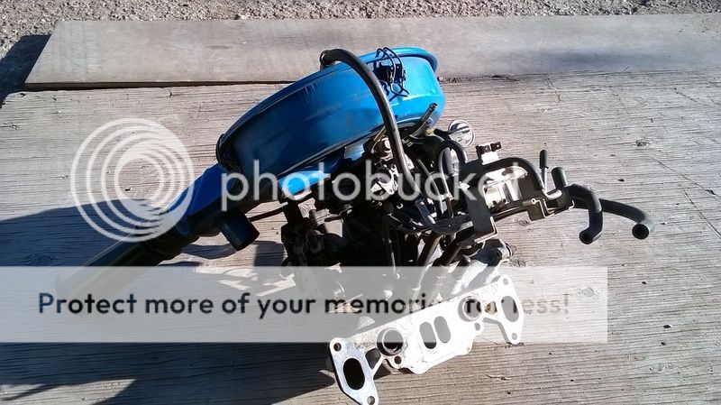

So my plan was to get rid of this...

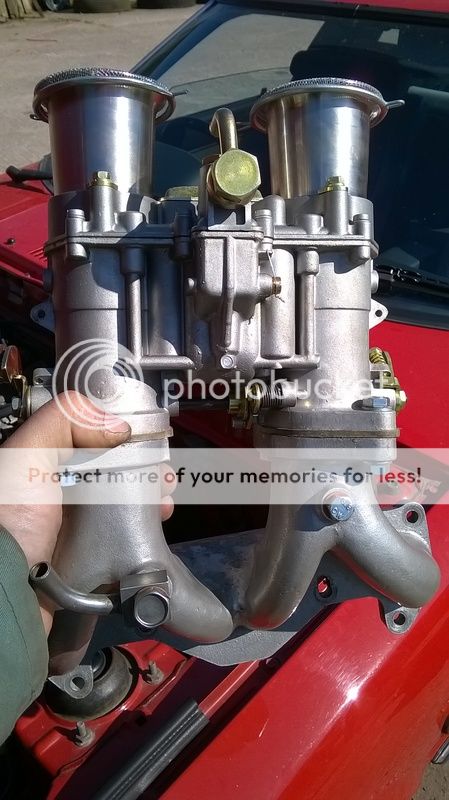

And replace it with this...

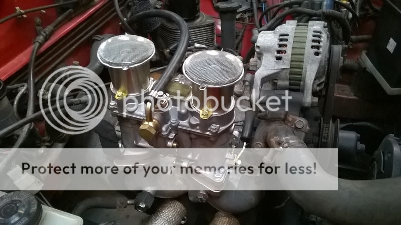

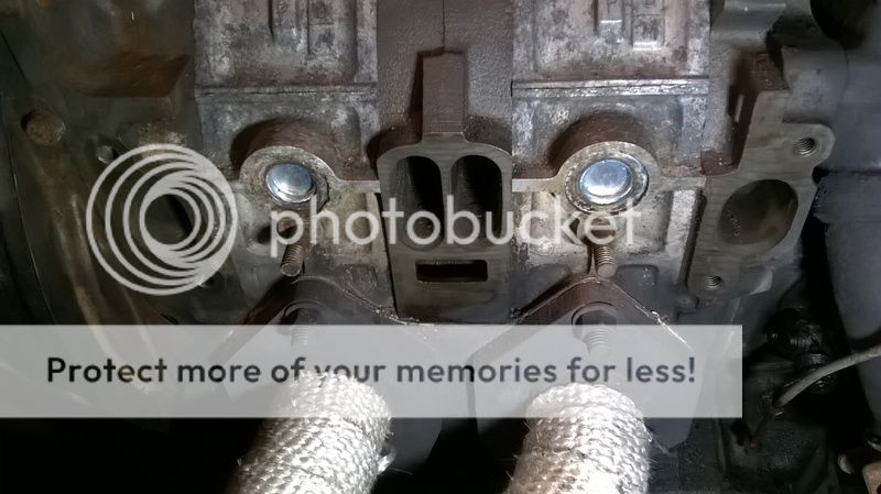

While I was doing the job I thought I might as well bang a couple of 20mm core plugs in so I won't loose my coolant if I remove the manifold, I also gave the rad and block a good flush through with the hose pipe. While access was good I decided to lag the exhaust to keep a bit of heat away from the carb.

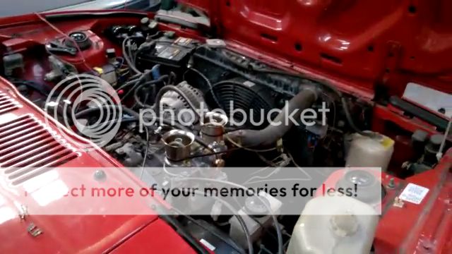

So 48 IDA fitted, did a little mod to re-use the omp lines and had to make a bracket for the throttle cable, I also used the cable quadrant from an old nikki as the IDA one made using the original cable difficult.
It started well, so I went for a blast and couldn't believe the difference, the torque in the lower rev range is far better and the engine is much more responsive so I'm a very happy bunny. By the way did I mention the noise, its addictive !

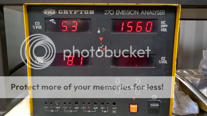

Got it on my gas analyser and this is where it seemed to be happiest...
