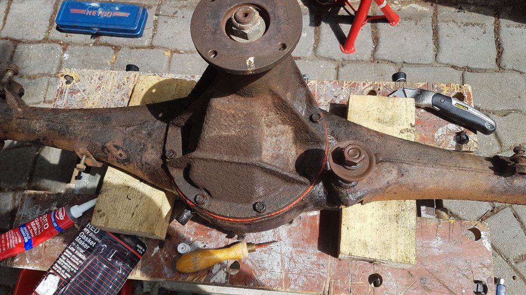

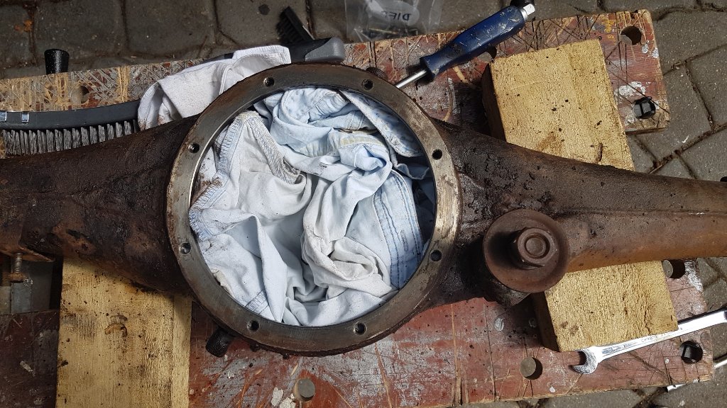

When lockdown started I decided to finally start my suspension rebuild. I bought poly bushes and a LSD some years ago. I also had new shocks at add, so when Pete and Dave decided to to buy new Racing Beat springs I joined in.

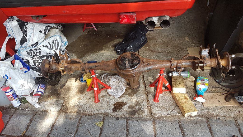

So with all the parts I started by removing the rear axle.
Removing the old bushes was another thing, they had to be burned out as they were still in very good condition, but never the less I wanted to fit poly ones.

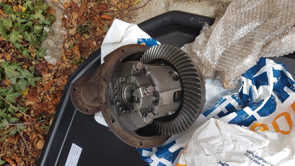

I've now removed the old diff and fitted the LSD. This turned out to be a lot easier than I expected it to be.
Still a long way to go manly prep and paint .... bring on the POR15

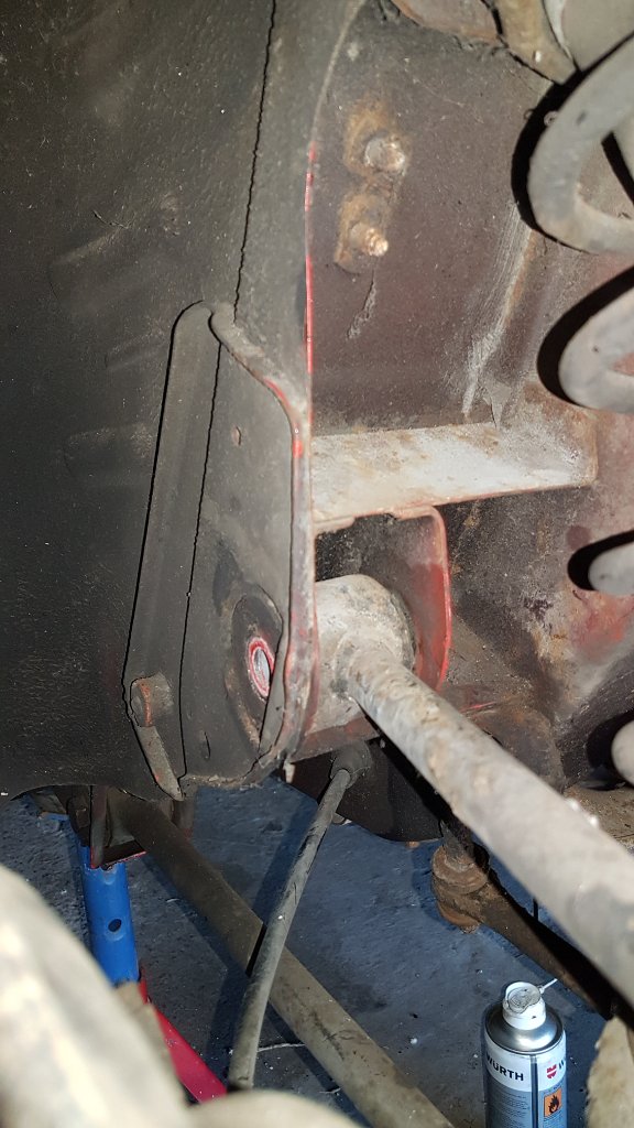

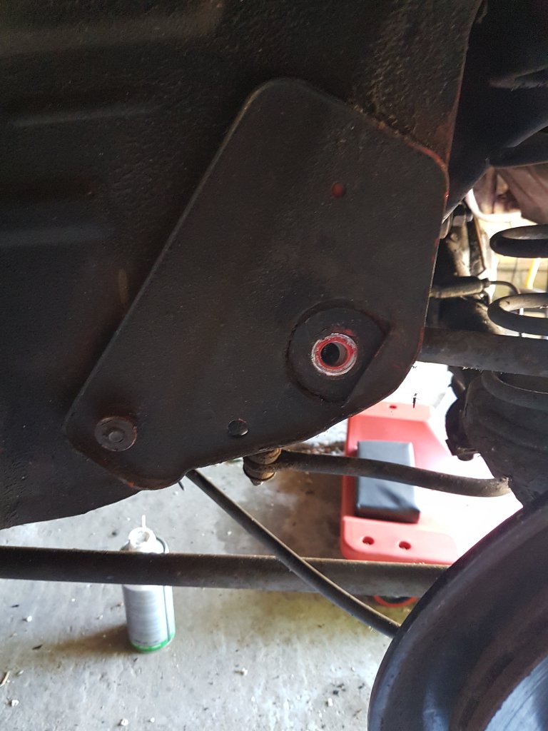

DKWW2000 wrote: Sat Jul 25, 2020 11:07 am Good work there Dave, keeping you out of mischief, I bet your aching in places you had long forgotten about :clap:
Pete, You wouldn't believe it, I must have pulled every muscle I ever had removing the tie rod bush mounts to the body lying under the car. :D :D

Re: Rear end rebuild

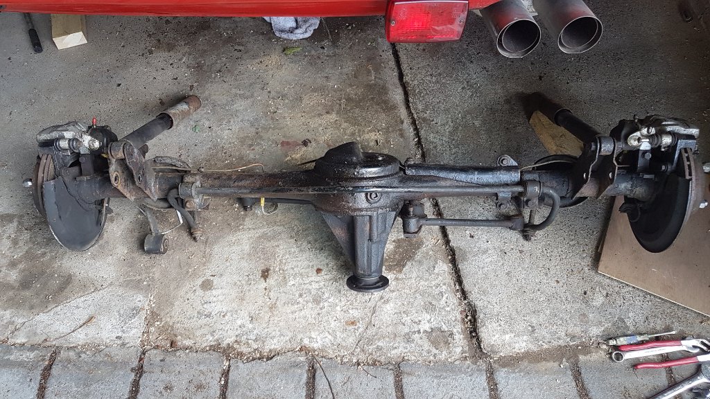

That looks really clean under there, and top job tackling the rear axle1

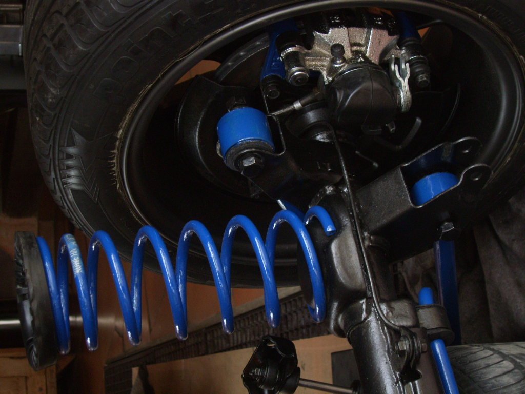

In 2013 i rebuild my axle too and coloured it with Hammerit "hammerschlag black" and Foliatec blue. 40 000km later in 2020 i am always happy with the result.

Looks very good Thomas, at the moment I'm thinking of
using red.
