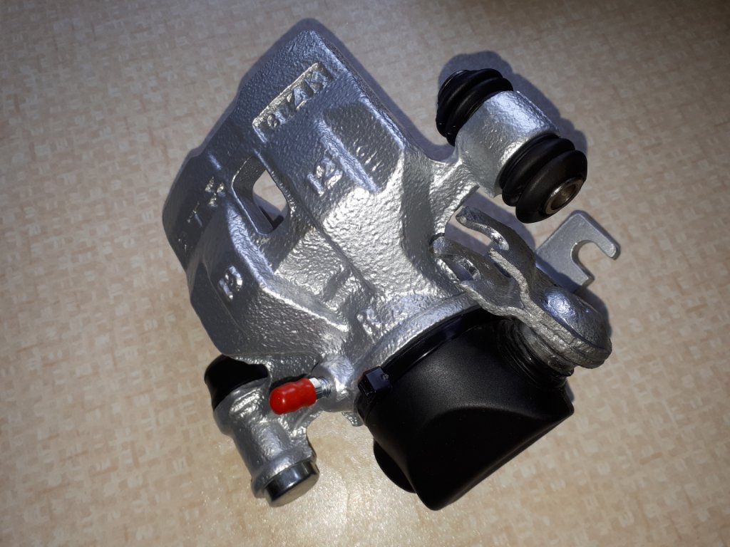

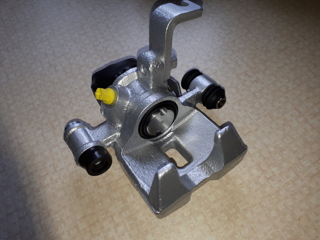

Refurbed caliper back from BiggRed, £107.40 inc VAT and shipping to me, using their premium paint finish (rust prohibitor, two paint coats and oven cured). Very pleased with the visual quality and the fact all the rubber items have been supplied too.

Just got to get it back on my car now :D
