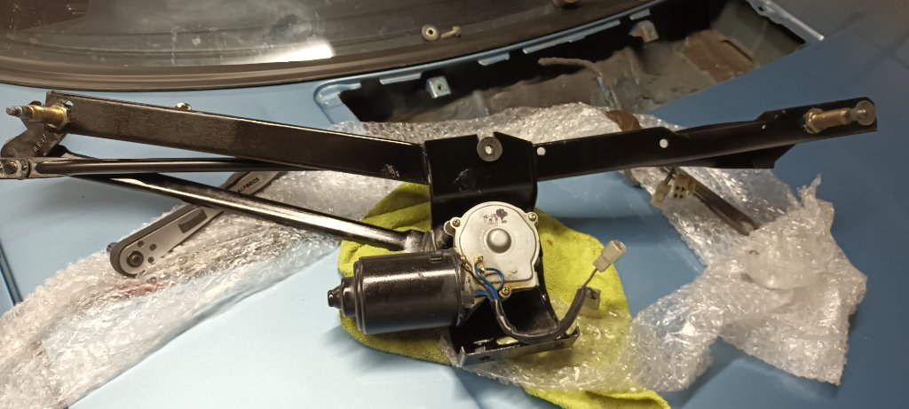

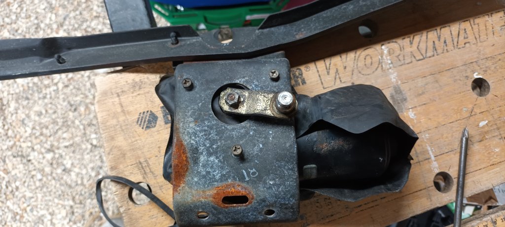

So, finally got round to visiting Tim @ RX Motorsxand picked up a replacement 13" wheel, front wiper motor mechanism, passenger electric window mechanism.
After much shouting, swearing, scratching head, I realised the trick to getting the front wiper setup out, was to partially rotate the wipers, by switching them on and killing 5he power so they stopped part way, easy then to extract. Repainted, swapped motor, replaced electrical connectors that disintegrated when touched and was back working.
Front passenger window, turned out to be all the bolts were loose, window had dropped off the front guard. Reset, greased up, tighten up bolts and now works well. Spare now kept for the future.

Painted up and ready
Old mechanism
Old mechanism
